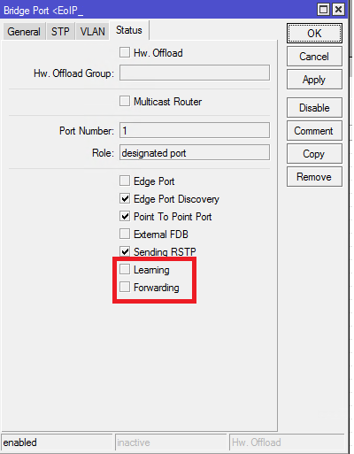

The problem is that in new Bridge (at CHR side) EoIP interface port status at “Forwarding” is not set to TRUE and learning status also is not set to TRUE (although learning status blinks from time to time). On all old Bridges EoIP interface these two statuses are true.

P. S. Attaching “Forwarding” and “Learning” problem screenshot.
