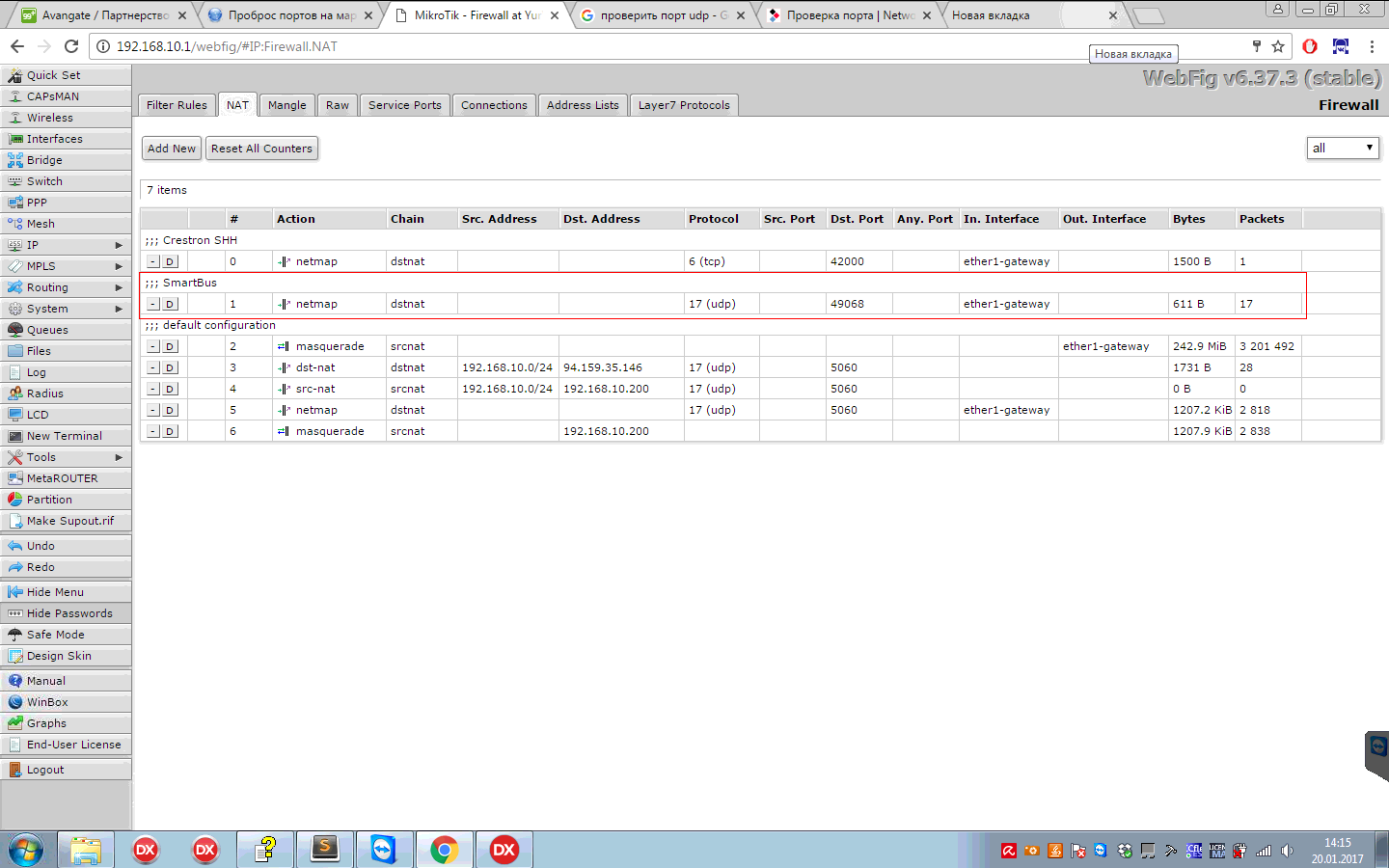

Please help me to find why my port forwarding on Mikrotik doesnt work.
I setup:
Chain dstnat
Protocol udp
Dst. Port 49068
In.Interface ether1
Action netmap
To Address 192.168.10.200
To Ports 6000

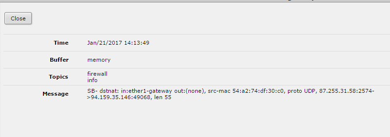

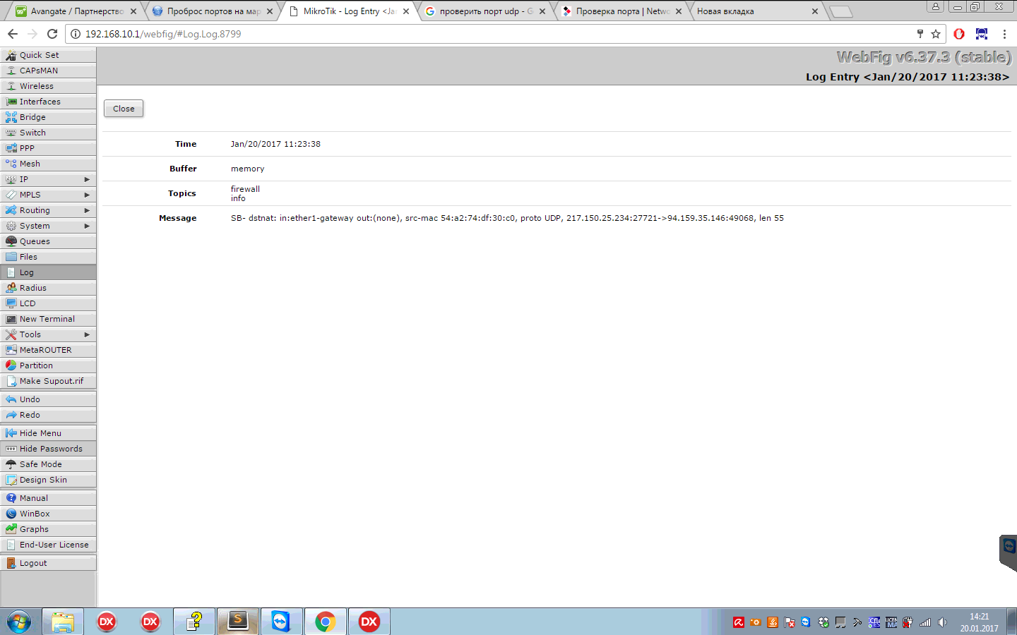

But when I try to send packages from external network router doesnt forward they in local.
In this case, the log record only one record.

Use action=dst-nat instead of the netmap. I believe netmap requires both dst-address and to-address and is intended to forward port for port.
Thanks, 2frogs.
I tried, but it doesnt work.
Got the same one log message.
That log just states that the router received a request to port 49068 from the internet, which is what is supposed to happen. It looks like your device at 192.168.10.200 is not responding to the request. Have you checked that it responds to port 6000 from the local LAN?
Yes, device with address 192.168.10.200 responds in the local network

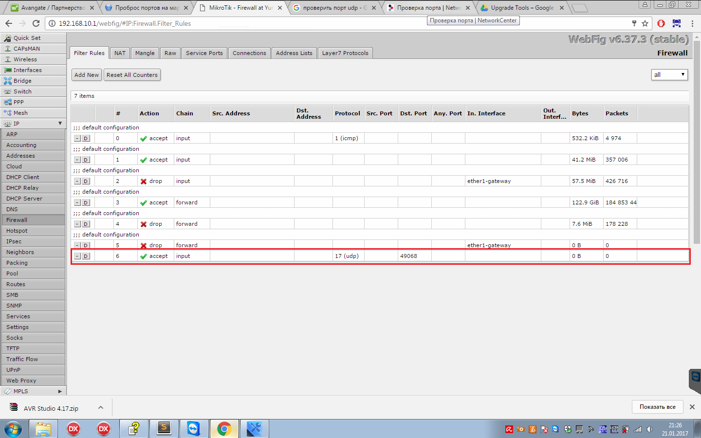

I add filter rule:
chain: input
Protocol: udp
Dst.Port: 49068
Action: accept
It doesnt help.

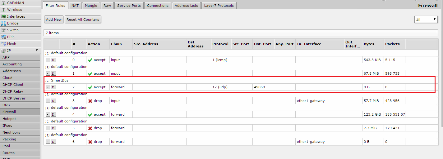

chain=forward
And order matters! You have to put accepts above drops according to chains…
Normally the default forward drop has a “connection nat state”=!dst-nat.
Change chain, order and set “connection nat state”=!dst-nat.
Unfortunately, doesnt help.

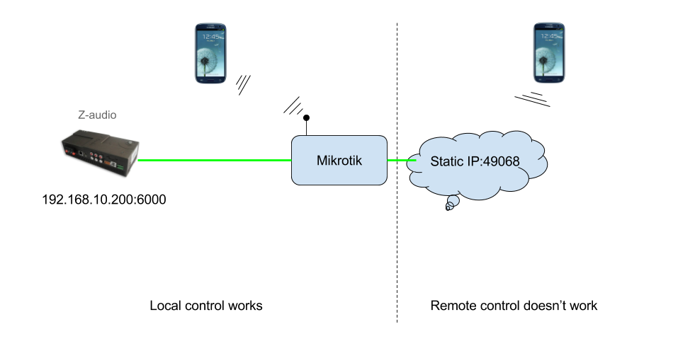

Yes. But it is not a server. I control device via phone. In local network it works fine.
But when I try remote control (from the other network) I doesnt see packages from my remote phone in local network.

Do you have other NAT rules working?
No. It is my first port forwarding experience.
Do you have other NAT rules to this server working?
No

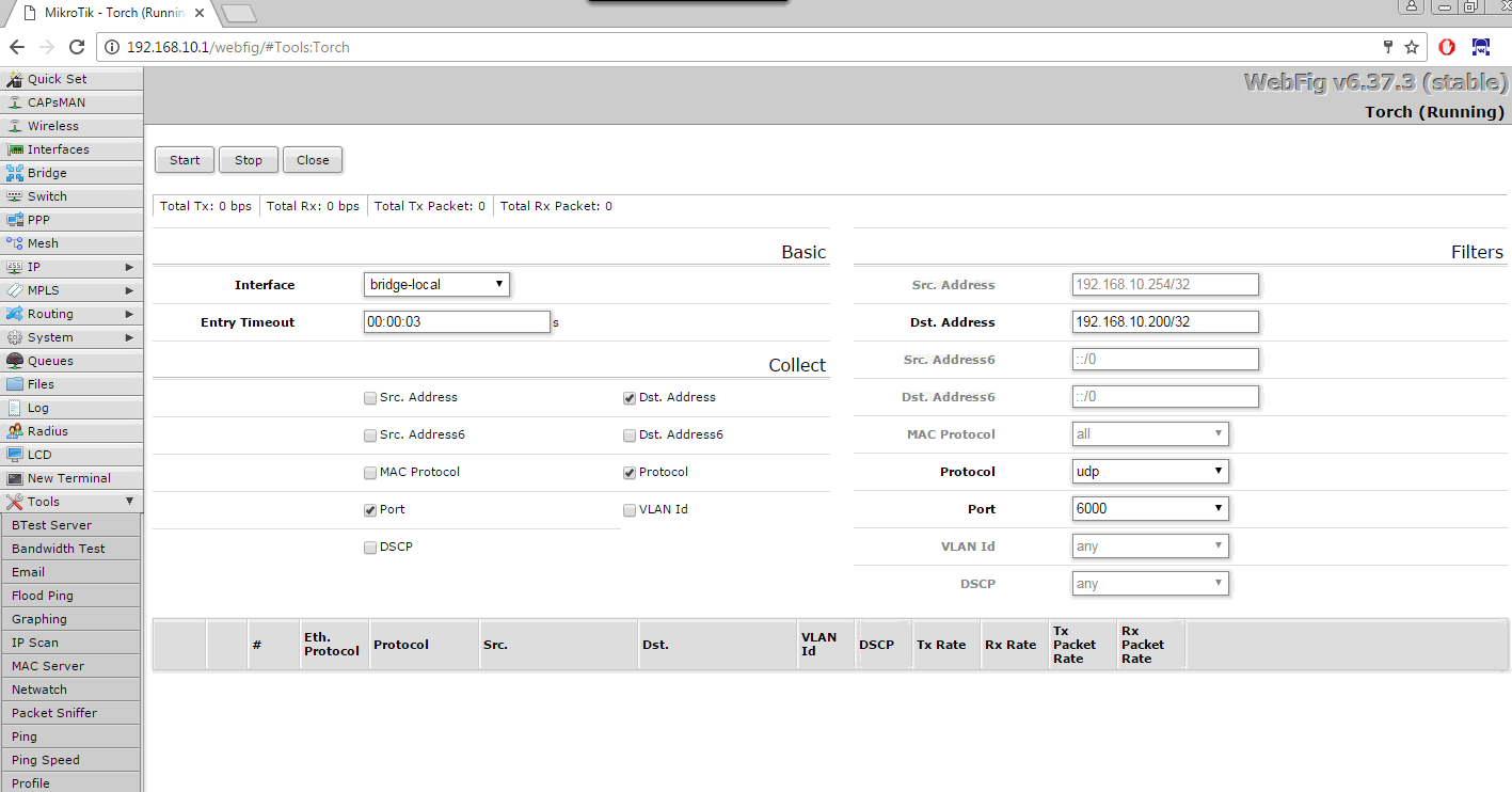

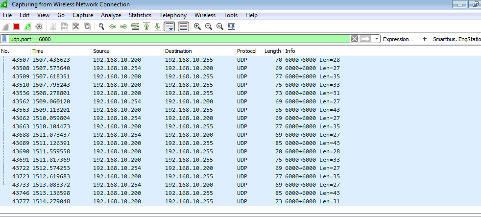

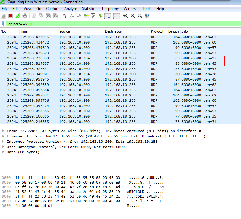

In the local network:
I tried Torch.
But I didn’t get anything from him, while Wireshark showed me packages.

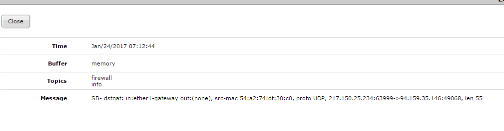

In the remote network:
I set checkbox “log” in my forwarding rule. But I get only one log message, then I send first package from phone from external

Most likely 192.168.10.200 does not allow packets from non-LAN addresses
But I doesnt see any packages in Wireshark from external network
or doesn’t have correct default gateway.
It has gateway address 192.168.10.1 – address of my router
