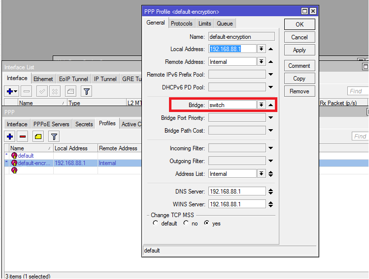

Ofcourse you can bridge PPP
Even add the address details. In your case it would be a public ip pool with static bindings.
