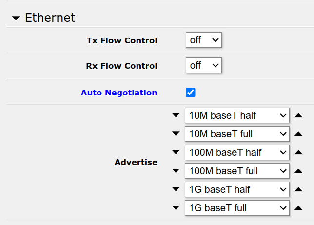

Have you tried to set the router switch not to auto sense the duplex and speed ?
If the Foscam have difficult to auto negotiate it’s speed and duplex.
https://demo.mt.lv/webfig/#Interfaces.Ethernet.1
Maybe you also can change the value on the interface in the Foscam.
