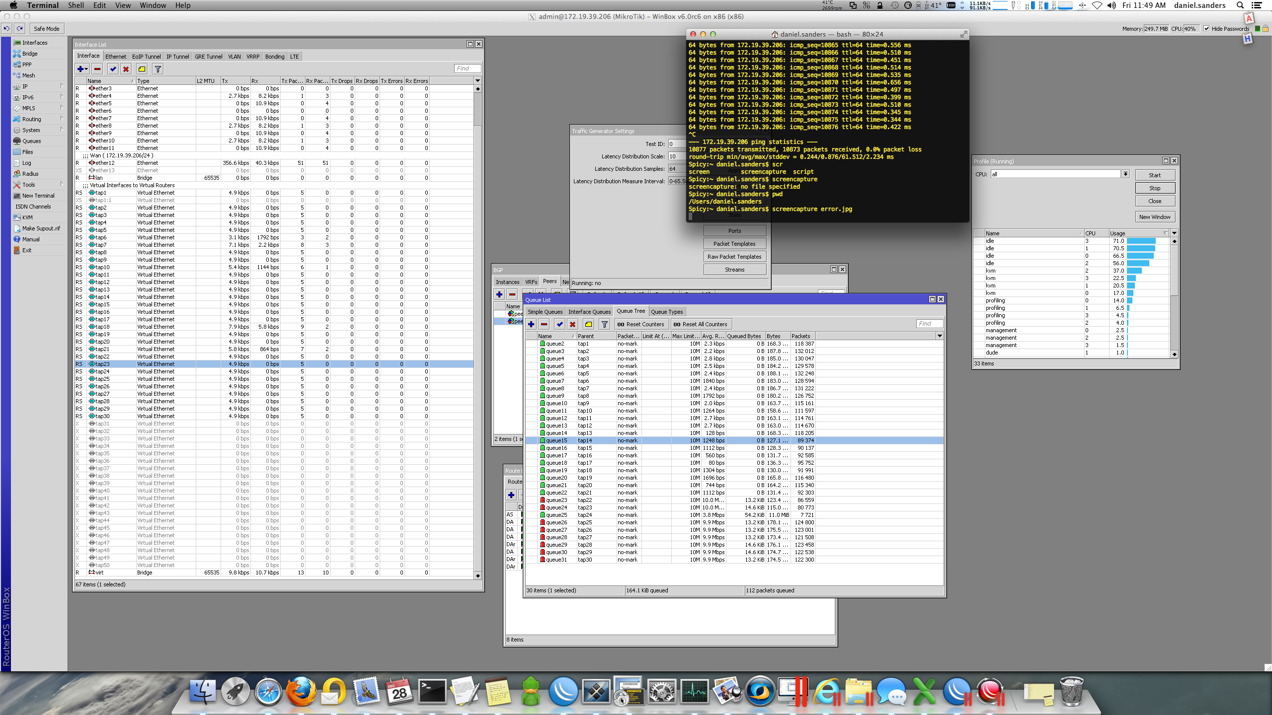

Issue is:
queue from 25 - 31 Fail
Please read carefully.
at first I start and only queue 1-24 show any stats on the queue tree -HOWEVER the interface is actualy queueing corrrectly at the set speed (10m/s)
issue is it wont show any stats at all
so i decided to disable queue 1-24 and enable only 25-31
then and only then did any stats show.
See picture below is when i -REENABLE- all queue’s, and then Stop the traffic generator
as you can see 25-31 are stuck at 9.9mb/s but there is absolutly no traffic on any interface.

while screenshot shows awesome resolution of your screen it does not tell exactly what is happening.

Queue tree’s 1 for each “virtual Ethernet Interface” the queues respond quite clearly
But with Simple Queues, it has very strange behavior, which is on display, if you look closely, you can see that there is strangely
Some queues that have a high amount of traffic at that “instance”, but the issue is, im not even sending any data, when i took that screenshot.
So if i was to cut to the chase of the issue, the last say 10 or so queues are stuck in motion the numbers do not change, UNLESS
i fiddle around and disable and enable the say 0-20 on and off, then ! and only then ! do the last 10 or so queues the figures/numbers change very quickly.
