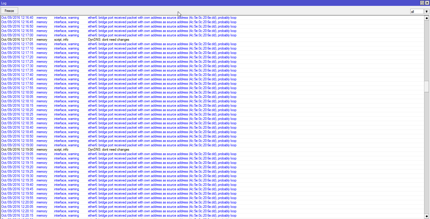

I have three routerboard and I try to test wireless roaming by follow with wiki (http://wiki.mikrotik.com/wiki/Wireless_WDS_Mesh)
after i run this lab. i found that loop packet on my network.
i use mesh interface for testing.
what i missed in this lab. Please advice me. how to solve this problem.
and now I moved to Bridge interface it work (I’m guessing that it have stp protocols to protect loop) if i want to use mesh how can i use the right way.
