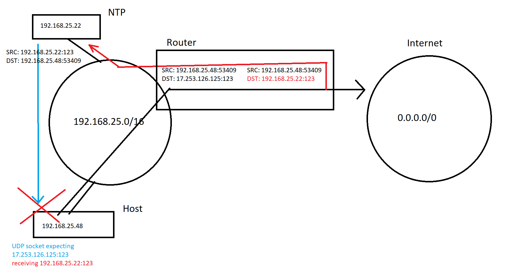

A related question: is your NTP server on the same LAN as the hosts you’re trying to intercept? I’m guessing they’re all on 192.168.25.0/24. If that’s the case, you’re going to have a problem regardless:
You might be able to get around that by also src-nating so that the NTP server sends the response back to the router, but I haven’t tested what that would look like.

Yes my NTP server is on the same LAN. I was hoping it wouldn’t care that the ip was different and only care that it got a valid NTP response back.
I’m very very ignorant on advanced routing, I’ll give it a try and see if I can work it out though.
Yes it cares - and be glad it does. Having your computing device accepting responses from a different IP address than they sent to would be a MASSIVE security problem.
