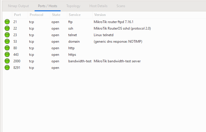

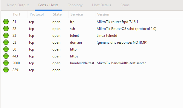

I ran the nmap -T4 -A -v for 6 sites (to their public IPs). At first I was alarmed because 4 of them showed open ports:
Then I realized that 3 of them only showed open ports because the MT devices have the following firewall rules:
/ip firewall address-list
add address=xxxx.dyndns.org list=xxxx
add address=yyyy.dyndns.org list=yyyy
add action=accept chain=input comment=“Allow xxxx src address list” src-address-list=xxxx
add action=accept chain=input comment=“Allow yyyy src address list” src-address-list=yyyy
To confirm, I went to:
https://www.yougetsignal.com/tools/open-ports/
And manually checked each site for the ports claimed to be open and found them to be closed.
The only site with a truly open port (443) is one where a Ubiquiti UDM is the edge router, and that port is open to allow log in/management access to the router.
