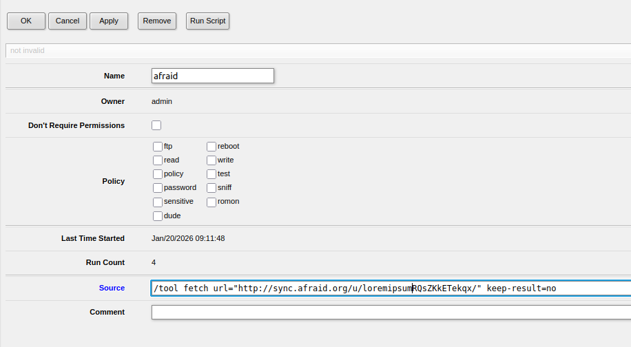

Can someone help me with the following script:
When I run it directly from the console it works and changes the IP of the subdomain:
[admin@MikroTik] > /tool fetch url="http://sync.afraid.org/u/loremipsumRQsZKkETekqx/" keep-result=no
status: finished
downloaded: 0KiBC-z pause]
total: 0KiB
duration: 0s
But if I run it from the web interface it does nothing:
Set "don't require permissions" or select "test" policy.
