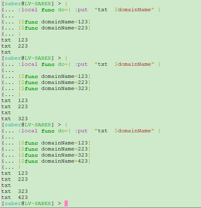

Every occurrence of an empty variable is on the third line.
Script Code:
:local func do={ :put “txt $domainName” }
[$func domainName=123]
[$func domainName=223]
Script Code:

In theory, the [$func domainName=223] should be harmless … but the does return a value of the inner command, which in the case of a :put, whose return is string. Somehow the subshell is calling the contained function again when exiting the block. That doesn’t seem right, but you don’t need the subshell operators either.

The actual problem is that no matter how many lines are executed,
after the second execution, there will be a phantom execution with empty parameters.
This is a bug in the RouterOS script interpreter itself.
Since it has been reproduced, MikroTik can fix it.
I believe this issue will be resolved in version 7.10.3/7.11 or possibly in future versions like 7.12.
Otherwise, it could be exploited by someone as a buffer overflow to execute attack code.

No, they won’t fix it. We reported a long time ago that when a function is executed twice in a subshell, it is executed three times. Woz and now there. Mikrotik doesn’t know how to fix the error.

already confirm in SUP-122073, will be fix soon.
