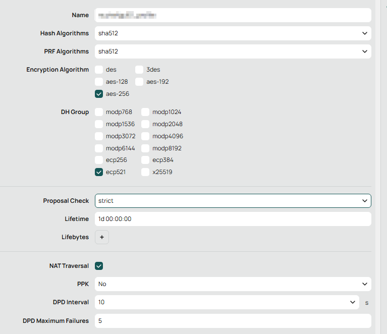

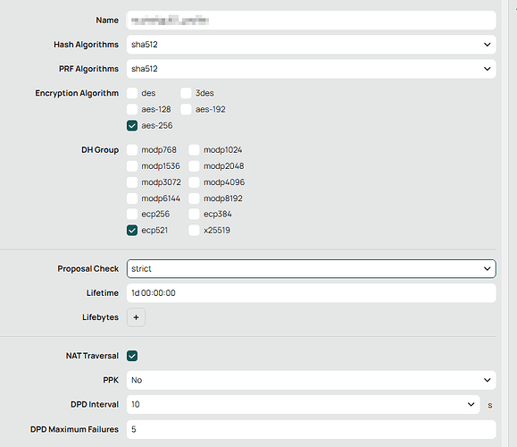

MikroTik IPsec Profile:
Sorry for posting twice, but I can only upload one image per post.

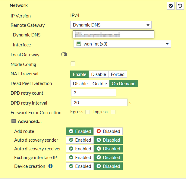

No, the DPD is configured on the Fortigate:
