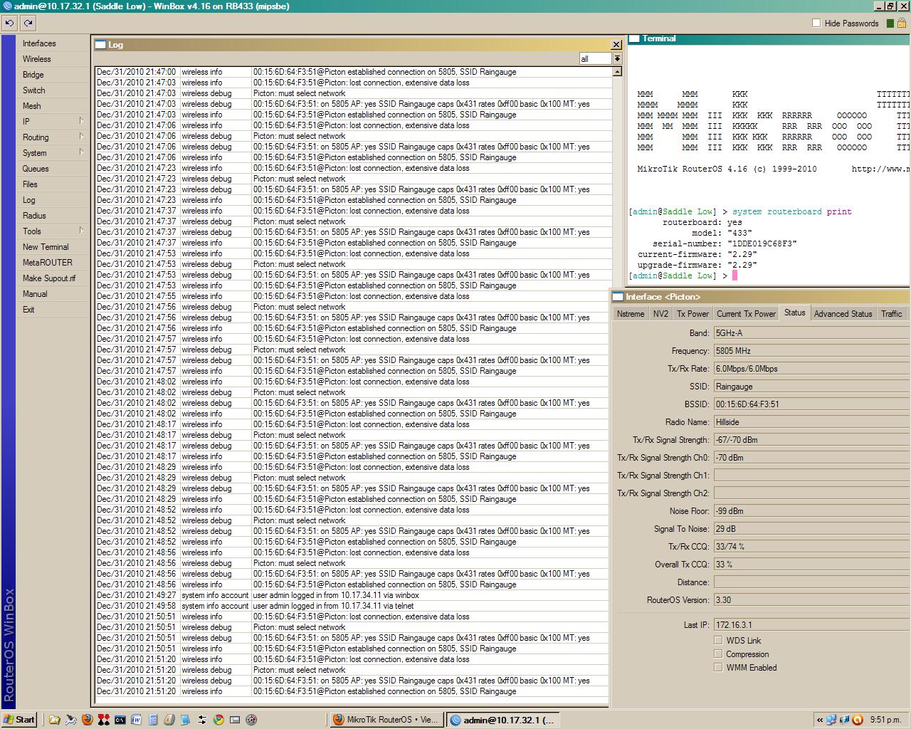

Here’s screenshot of one of my stations logging brief (<1 sec.) disconnects every few seconds.
In between, as you can see, signal strength is fine. The board is a RB433 with a R52Hn card. The other end of a point-to-point link of 18km is an RB 532 with (I think) an SR5. nstream is running
Any more information required, please ask. Any hints, pointers, explanations gratefully received.
Just my thoughts on this - a link with different boards+radio cards can give unpredicable results, I would first have identical hardware on both ends, second what type/gain antenna is being used, CCQ is low at 74 and overall ccq of 33% explains why disconnecting, and was traffic being sent while you took screenshot. even your rx/tx rate at 6Mbps cannot give you a solid connection maybe radio card(s) faulty or antenna off alignment :open_mouth:

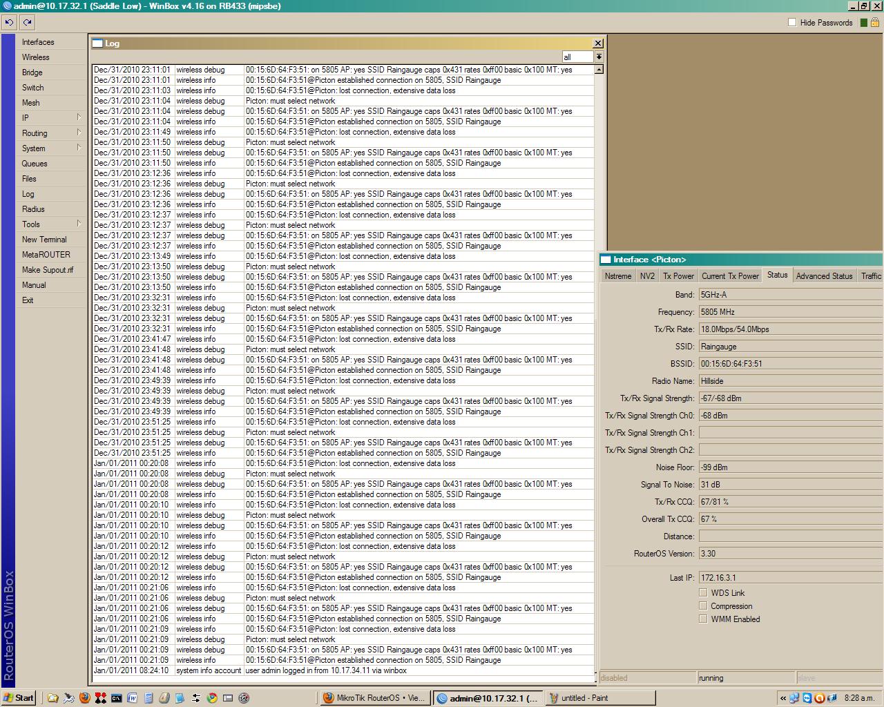

Here’s a shot from this morning - the problem stopped at 21 minutes past midnight and the link has been rock steady for eight hours. CCQ is up to 66% and jumps to >90%.
Antenna are 22dB parabolic. Misalignment is possible - we had 160kph winds through Wednesday night - but then why would it come right?
