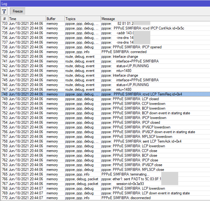

I’m having this same exact issue, where the log just fills with those errors. I believe the issue is on the service provider’s end, (in your case, where ever you are trying to log into). Check the connectivity on the other end of the pppoe connection to see if that is occasionally losing internet connectivity.
im facing this issue also.
Having same issue as well. Can someone please confirm if issue was resolved by ISP? I have raised this with my ISP and my issue is currently under investigation. It would be great if someone can please confirm.
This topic was the 1st result so posting here.
In the same boat with my RB1100AHx4 Dude using PPPoE.
Randomly, after a clean reboot or firmware upgrade, the PPPoE connection will loop forever.
The only fix is to reboot again or disable/enable the interface connecting to the GPON.
I have never experienced such problems with any prior routers in this location. Plenty Asus routers and X86 PFSense/IPFire machines.
I let it for 10 minutes last time it happened. No luck.
I had to disable ether1 and enable it back. Instant PPPoE connection.

Hello. This is the dump of pppoe debug, if it helps:
When I disable and enable PPPoE Client, or reboot the RB, the connection is done at first try. But when I disable and enable the PPPoE Client ethernet interface or restart the GPON, it keeps trying to connect about 30-70 times util get success and stop cycling.
Your log shows that the connection establishment has succeeded, and almost immediately after the PPPoE server asked your client to terminate it. Without seeing the sniff, I can only guess that your Mikrotik kept sending from the previously assigned IP address, and that was the reason why the server has requested to terminate the session.
