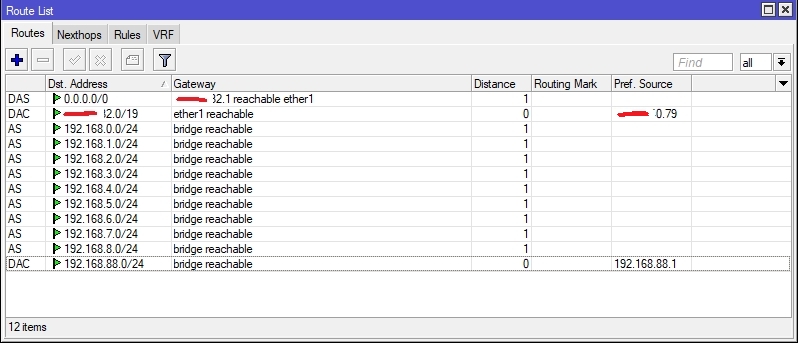

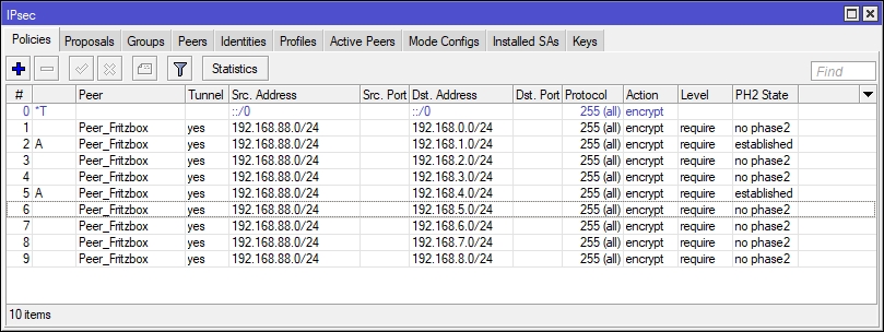

ok, it’s working now :
1 - adding Routes in mikrotik to the networks behind fritzbox
2 - creating for each Network a Policy
is this correct ?? Actually its not always showing an established PH2 State but I can ping and load webpages in this networks
Secondly what is the Status ‘A’ standing for ? as well as does this way slow down my fritzbox ? Any other solution ?
