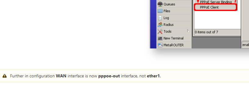

I decided to work through the Getting Started documentation https://help.mikrotik.com/docs/display/ROS/Getting+started and came upon this statement in the First Time Configuration, after PPPoE is setup:
But, nowhere can I find out a justification for “Further in configuration WAN interface is now pppoe-out interface, not ether1”. Many people advise on this forum to have an Interface List “WAN” and have ether1 and pppoe-out1 in it and use WAN as the interface in firewalls, NAT etc.
