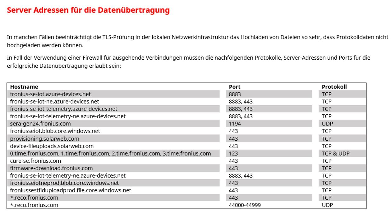

Hi guys,
I’m relatively new to Mikrotik routers. I finally managed to get my fibre internet working with a HEX S router with a SFP module and latest stable FW.
Everything works fine except my inverter can’t connect to the services. There is a list for ports and hosts needed see list.jpg.

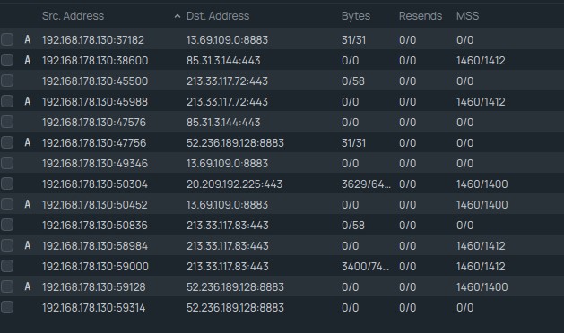

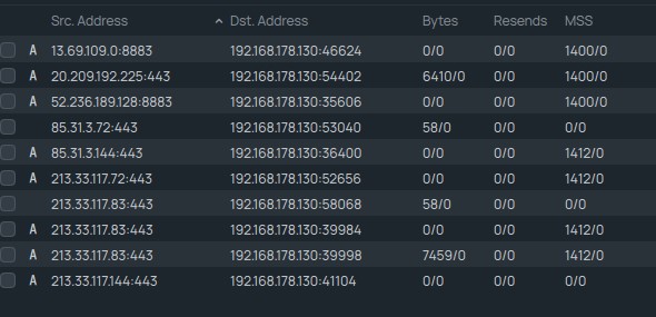

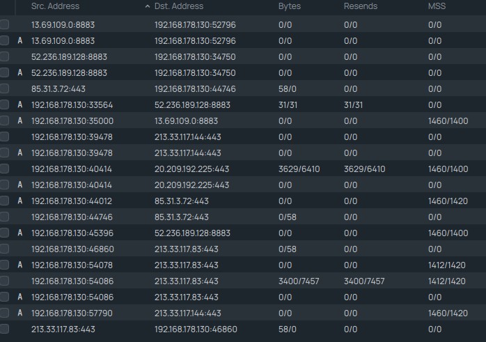

  1. recorded packets, as the inverter still can’t connect to the ports

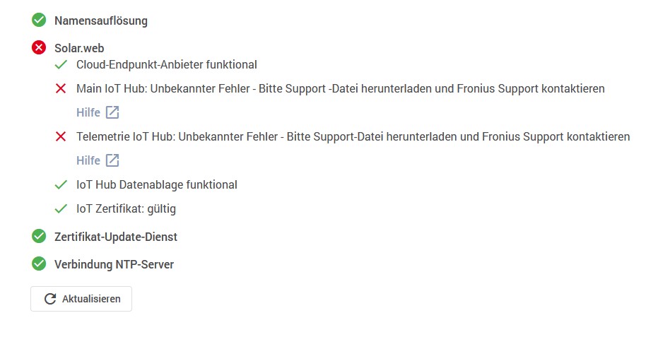

Has anyone any ideas what I’m missing?
With the default configuration anything initiated from a LAN device has access to the internet - you don’t have to add anything, so what are you trying to achive with these additional rules?
From the start, the inverter can’t access the cloud. Thats why I tried to give the IP of the Inverter access to the ports. But that didn’t help. Router has default settings and this is the only thing that’s not working. Any help appreciated, I’ve been trying for days and I’m out of ideas.
I have to add, my fibre connection is through a ipv6 tunnel and PPPOE. Maybe that has anything to do with this error.

In their manual it says there are problems with failed TLS checking - could this be a reason?
I found a few forum entries about this problem, but no solution so far, thats really frustrating

See the packets I’m getting are from:
fronius-se-iot.azure-devices.net
froniusseiot.blob.core.windows.net
fronius-se-iot-telemetry.azure-devices.net
http://provisioning.solarweb.com/
device-fi leuploads.solarweb.com
→ deactivated the NAT setting, TCP-Clamp on tunnel is activated all along.
It must have to be someting with that DS-LITE, but I have no clue what it is.
“In Fall der Verwendung einer Firewall fuer ausgehende Verbindungen”. lol. “Im Fall” would be correct. But that’s just a side note. The point is: only outgoing connections are needed. According to that “list.jpg” there is no need for:

Oh oh, I smell a lot of MTU tinkering. This may be the source of your connectivity issue.

You could run Packet Sniffer on the interface to the inverter, see what it’s trying to do, and whether it’s getting replies.
OK guys,
I finally managed to get it working.
Good news is inverter is sending data. Bad news I still get errors when doing service test on inverter website.
I came across a similar topic, where tcp-clamp was adressed in firewall mangle for both directions. I only had it defined for outgoing traffic. Since that change it’s somehow working.
