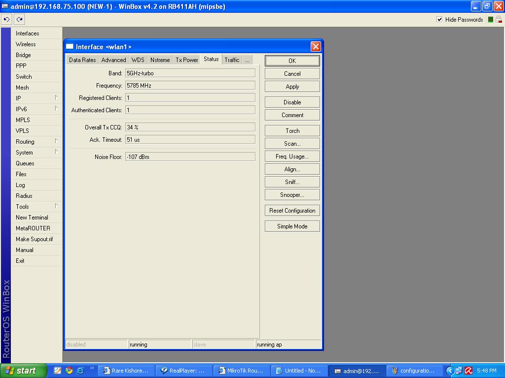

You have too low signal strength for 5GHz-turbo. Use regular 20MHz channel wide and you get more stable link.

i noted something may be this is the cause..i m using 26 dbm but when i see the card tx-power in both boxes its shows as under: if i m not mistaken it shd be 26 dbm, sorry for bad english.. and even if i try to increase it manually the signals dont even increase by 1dBm
