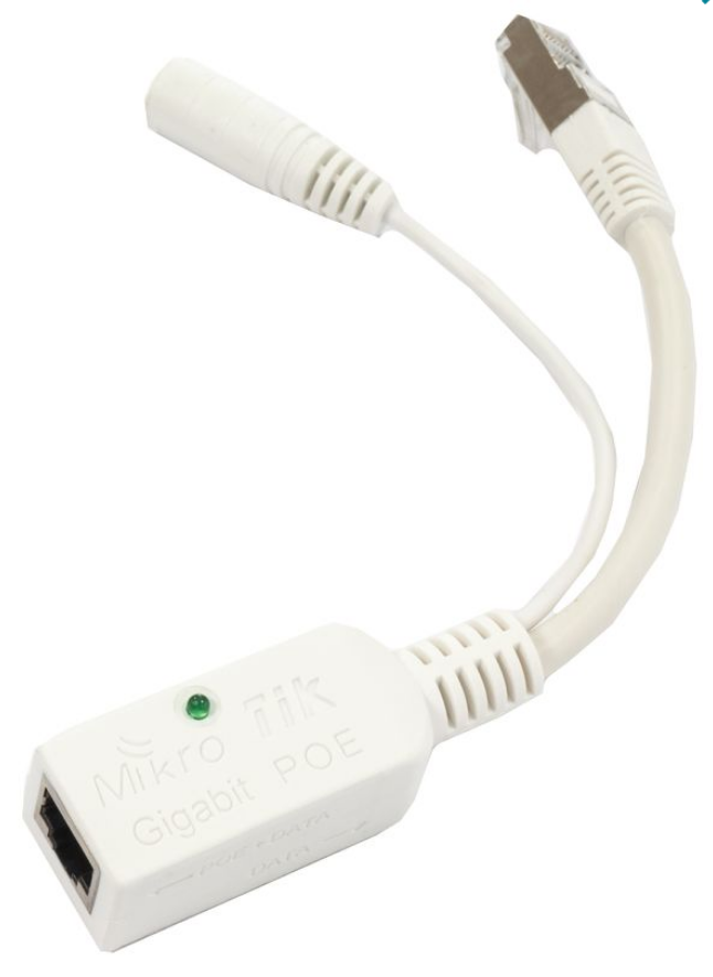

How are you powering them?
Guess it comes with a POE injector like this one (RBGPOE):
You should:
  • plug the RBGPOE male RJ45 onto your Switch Gigabit Uplink port
  • Take a standalone ethernet cable, then plug one end on the RBGPOE female RJ45, and the other to the FTC RJ45 socket.
  • Plug FTC power adapter to mains, and then the power adapter DC jack to the RBGPOE DC power socket.
Thank you, not sure why I was so stubborn to think the dongle was suppose to plug into the fiber converter.
Some routerboards accept both kinds of powering, i.e. POE, and also direct DC jack plug.
FTCs have high chances to be installed outdoors, or on unconvenient places, only accepts POE powering both for convenience and to keep costs down.
