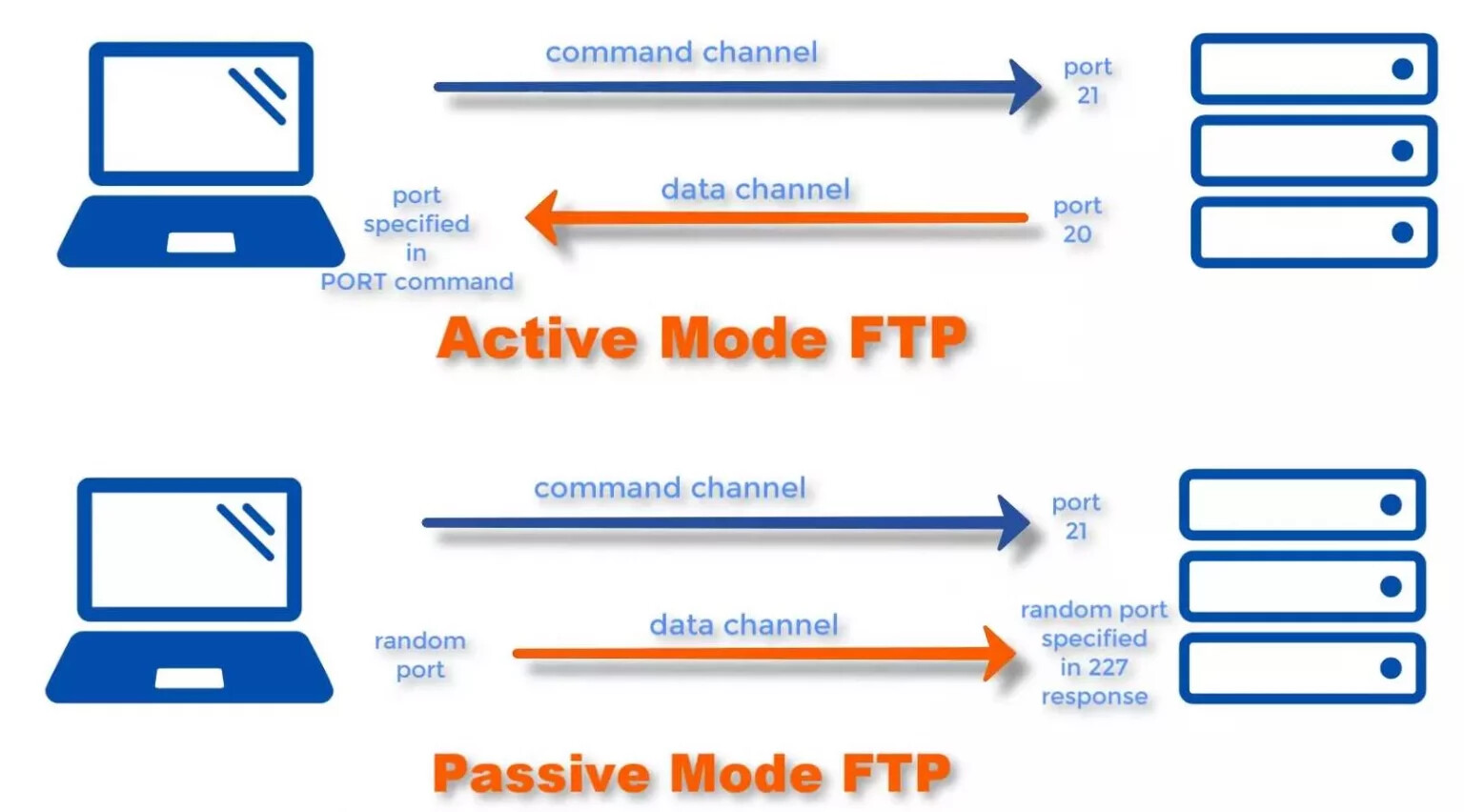

When using ftp you may consider learning about how ftp works, and how to use it properly.
It open up port’s that not being open.
Try to enable/disable PASV(Passive mode), first in you client app.
Then you can see in this picture how the traffic goes
