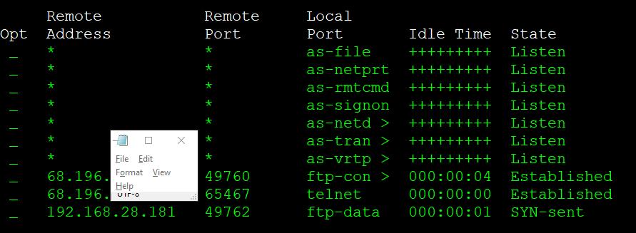

The FTP control channel (port 45121 to Server B port 21) works fine. I can log on with DOS FTP. So far, so good. But as soon as I try to do a GET or an LS, etc., it hangs. The server is attempting to open a channel back to the internal IP address of the laptop (192.168.28.121) at Grandma’s house instead of the public IP address of Grandma’s router 68.196.x.x .
so the first challenge is - how do I get the server to understand it should be shooting for the external router IP at Grandma’s house?
The second challenge may be - the data channel is shooting for port 20 (aka ‘ftp-data’ in AS400-speak). I don’t know if the router at Grandma’s will be able to understand incoming port 20 since the outbound went out on port 45121 instead of 21.

I can’t control the client end. In this case, the client end is using an Asus RT-AC53U, a pretty good router. I don’t know if the client router is configuring the connection such that the passive connection attempts to contact the Asus external IP, or if the MT is doing something different based on an incoming port 21. But when I ftp on port 21, the port 20 return connection looks for the Asus external IP. When I connect to FTP on port 45121 with port translation, it tries to connect to the internal IP address of the remote client.
