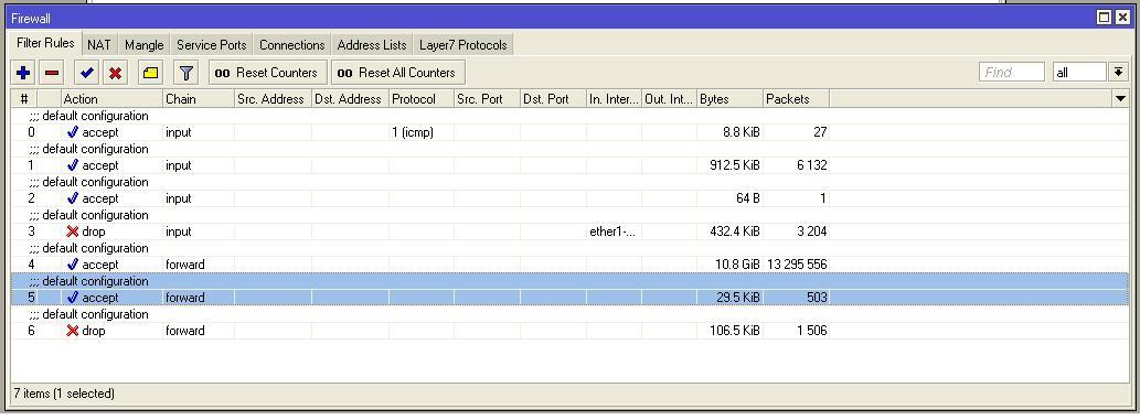

Nat and firewall rules:

Remove the port 2121 dstnat rule.
I don’t understand a couple of your filter rules, like #1 and #2. Looks like they are identical from here. What is the purpose for them? I see no protocol. I see no src address or dst port.
Add this rule and move it to position #1. Does your ftp work after that?
add chain=input action=accept dst-port=2121
move 7 1
Thank you, SurferTim, you are my “Top Gun”… it works now. I did’nt set any filter rule, they came from"default configuration" , I believe.Anyway ,I remove #2,seems redundant. You should create a book regarding mikrotik ftp server settings, from A-Z,IP services,service ports,filter rule. Now, will see if MT ftp server is reliable enough, many routers with usb port and ftp server loose files soon or a later( I’m using ftp to store files from my IP camera’s).
