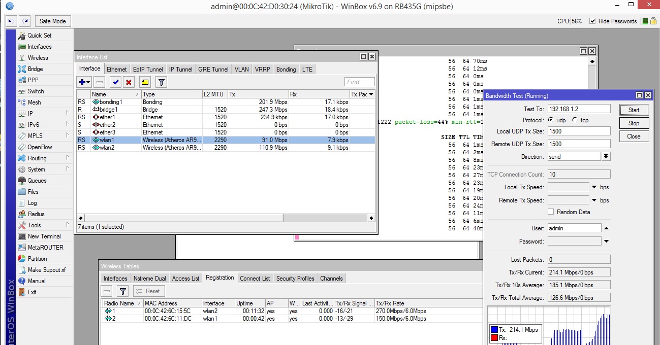

This is my first 40Mhz N test but I m not very happy with that too much self interference
Ill remake test with RB800 in better conditions tomorrow + Ill do 2x 60Mhz Test -advanced channels
And one more thing I can not make nv2 to work dont know why (2xwlan on one board) - if u use 4xSXT it should work because wireless card basically are on separate boards
Signals are too high at -13,-16, -29dBm, you could and probably are overloading the radio cards at those levels, self interference is no surprise.
I try to lower the output power but no luck
wireless cards were not just overloading, u just cant imagine how much they were overheating ![]()
to saintofinternet in good condition u can get something around 200mbit TCP and 300mbit UDP using 40Mhz channel width
real question what I want to try is how much I can get using 60Mhz channel
