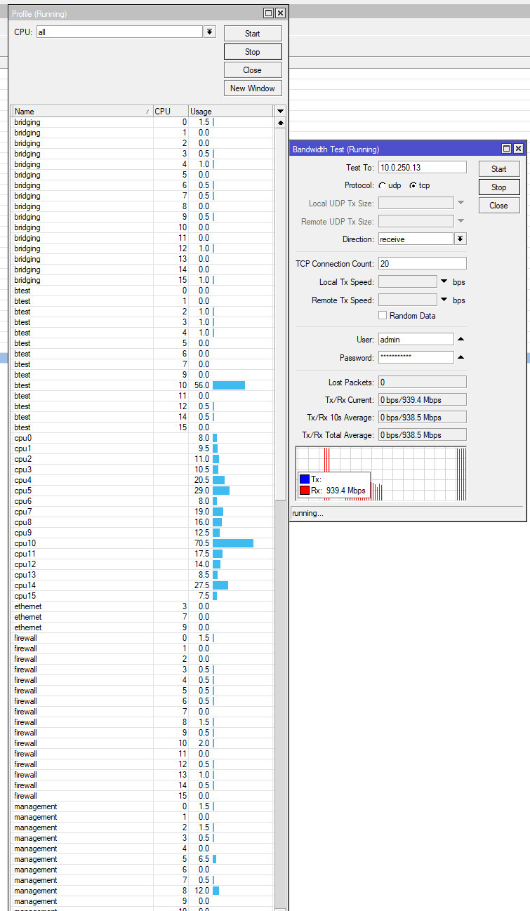

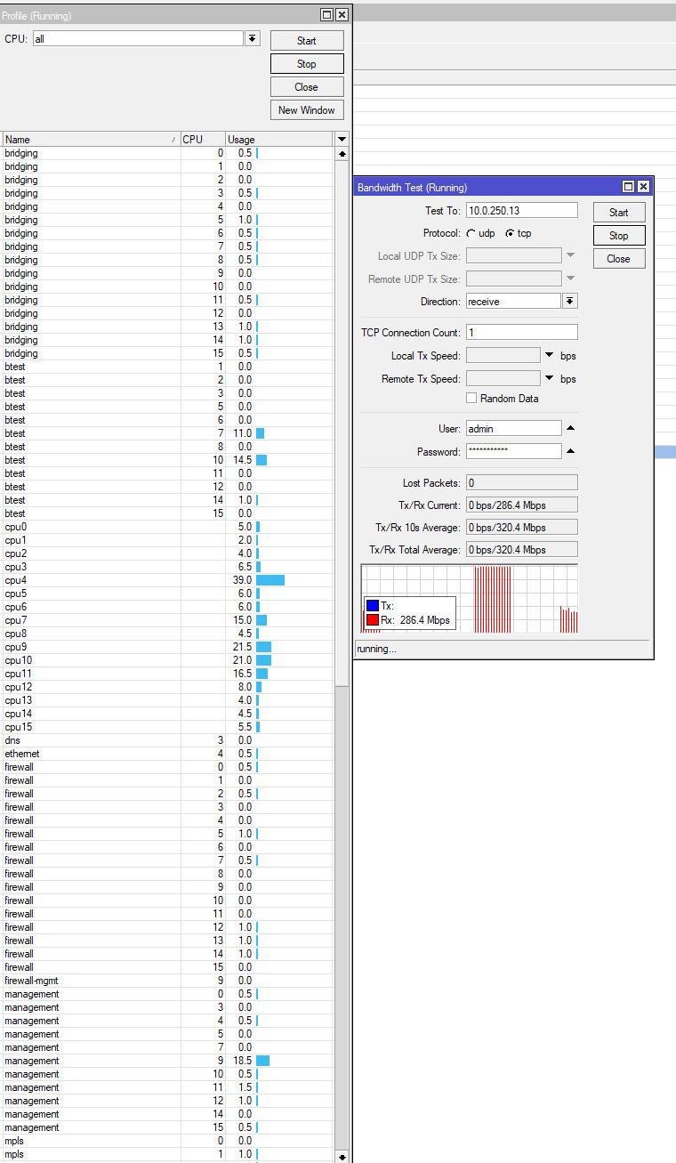

so. I have now done two more tests. with 20 simultaneous connections a CPU comes to 100%, it runs 940 Mbit / s (interface 1Gbps). With 1 possible connection is no !!! CPU to 100%, but only 300 Mbps. So not on the CPU?

I see, the CPU of BWtest-Server is on 1 Session on 95%. :frowning:
