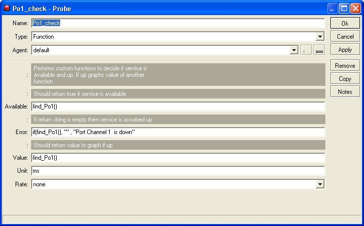

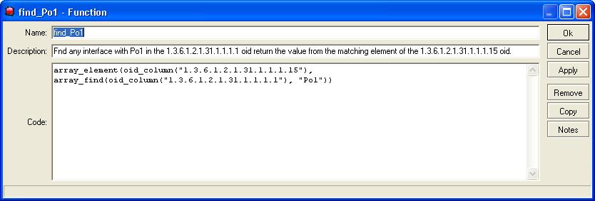

Here is a probe that calls a function… I don’t know if this will help but it could be a start.
This is a probe that I was working on to determine if a port channel is working.
It could have been used but I didn’t add it to anything.
As far as things not responding to every SNMP querey I seem to get plenty of them but they seem to be caused by The dude and not because the SNMP read failed.
Oh also search for the Probe Thread for some more information.

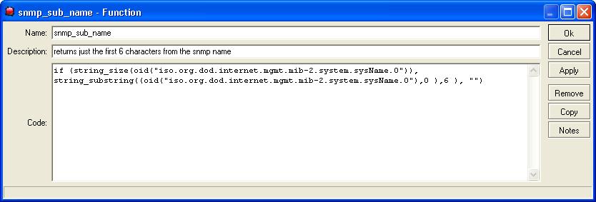

use string_substring to return just the characters you want… here is an example.
This returns 6 characters from the oid sysname…
if (string_size(oid(“iso.org.dod.internet.mgmt.mib-2.system.sysName.0”)), string_substring((oid(“iso.org.dod.internet.mgmt.mib-2.system.sysName.0”),0 ),6 ), “”)
HTH

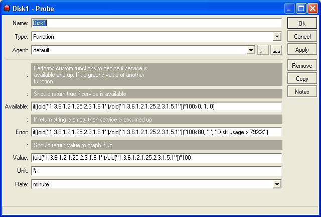

For disks I made disk1, disk2 all the way up to 5 all specific for oid then just manually attached them. They show up as graphs of % of used spance. The end result is the same they complain at a set % of utilization. This was discussed and copied directly from the probe thread. Will this not work for your situation?
if((oid(“1.3.6.1.2.1.25.2.3.1.6.1”)/oid(“1.3.6.1.2.1.25.2.3.1.5.1”))*100>0, 1, 0)
if((oid(“1.3.6.1.2.1.25.2.3.1.6.1”)/oid(“1.3.6.1.2.1.25.2.3.1.5.1”))*100<80, “”, “Disk usage > 79%%”)
Disk #2 is 6.2 and 5.2, Disk#3 is 6.3 and 5.3 and so on…
