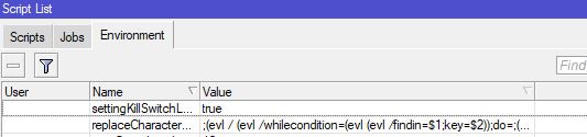

The strange code called Eval, is coming from the word evaluate I assume:
;(evl / (evl /localname=$input;value=$1) / (evl /localname=$q) / (evl /localname=$r) / (evl /localname=$output) (evl /ifcondition=(< $input 1024);do
=;(evl (evl /setname=$output;value=(. $input  B)));else=;(evl / (evl /ifcondition=(< $input 1048576);do=;(evl (evl /setname=$q;value=(/ $input 1024)
) / (evl /setname=$r;value=(- $input (* $q 1024))) / (evl /setname=$r;value=(/ $r 102)) / (evl /setname=$output;value=(. $q . $r  KiB)));else=;(evl
/ (evl /ifcondition=(< $input 1073741824);do=;(evl (evl /setname=$q;value=(/ $input 1048576)) / (evl /setname=$r;value=(- $input (* $q 1048576))) /
(evl /setname=$r;value=(/ $r 104858)) / (evl /setname=$output;value=(. $q . $r  MiB)));else=;(evl / (evl /setname=$q;value=(/ $input 1073741824)) /
(evl /setname=$r;value=(- $input (* $q 1073741824))) / (evl /setname=$r;value=(/ $r 107374182)) / (evl /setname=$output;value=(. $q . $r  GiB)))))))
) (evl /returnvalue=(evl (<%% $output (> $output)))))
Why does it display the Eval code?
By using :put $human you ask ROS to print the code of the function and it then displays then the code already converted to Eval.
By using :put [$human] you ask ROS to give you the result from the function.
By using :put :human 13 you ask ROS to give you the result from the function and the parameter 13 will be stored in $1 (special variable) inside the function.
When you store a function in Global then it is also stored converted to Eval code. As you can see underneath.
