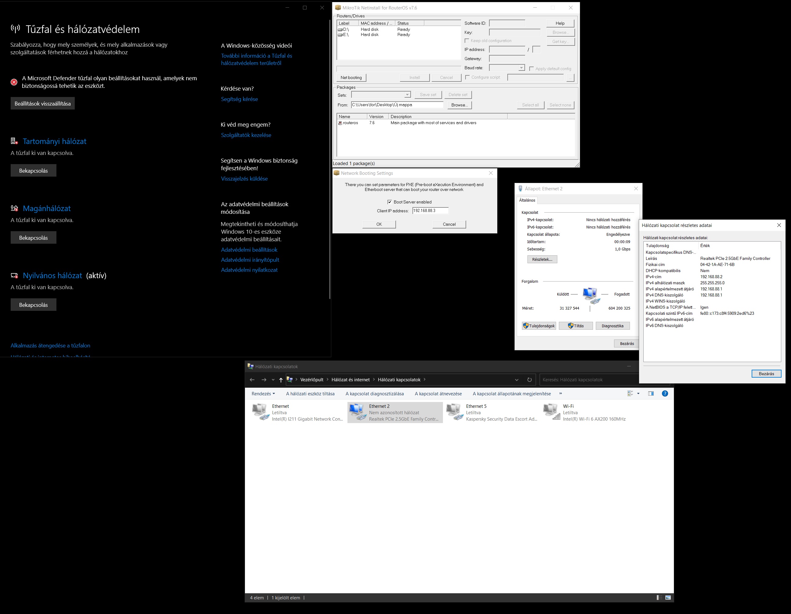

Hi! I faced the typical error. After power outage bricked my RB4011. Worst of all, I made the mistake of not having backup of the configuration jungle.
I have experience in electronics and I willing go any lengths to extract the configuration. Even dump the flash memory, I have a complete RT809F programmer for it.
What I tried:
-Connect via Netinstall. Failed. The router light up the ETH1 led for about 30s, the PC recognised, but won’t show in Netinstall. Firewall, other adapters disabled, IP settings as in the attachment. Tried 2 pc’s

try netinstall with a dumb switch between PC and RB4011
good luck
Thank you really much! With switch did the job done. After 30 times, gave me a the connection. :laughing:
