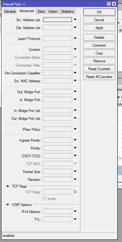

Your default input drop rule has a setting of tcp-flags=“”
This is probably the problem. Remove any reference to tcp-flags and it should then catch anything not specifically allowed before that.
Sent from my iPhone using Tapatalk
The current rule set works.
You are correct it works - but I would still recommend removing that section of the rule as it is not required
It is common when rules have been checked in Winbox and options opened but not actually filled in for entries like that to get left behind as orphans.
In this case nothing is active but I have seen connection state rules left open but with nothing ticked so the rule looks for connections that are neither invalid, established, related or new and never catch traffic so best practice is to remove such entries.

Ok. I don’t recall fiddling with that rule except to disable and then enable it. Thus, I presume that it’s how the people at Mikrotik defined the default rule.
