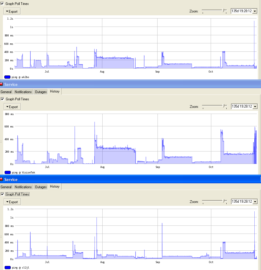

I thought this was interesting, There is no way any of devices below would ever be higher than 10ms to ping… Notice how the graphs are similar. From what I can tell if the dude calculates a rtt of 50ms it will most likely calculate that again and again even if it is not correct.
