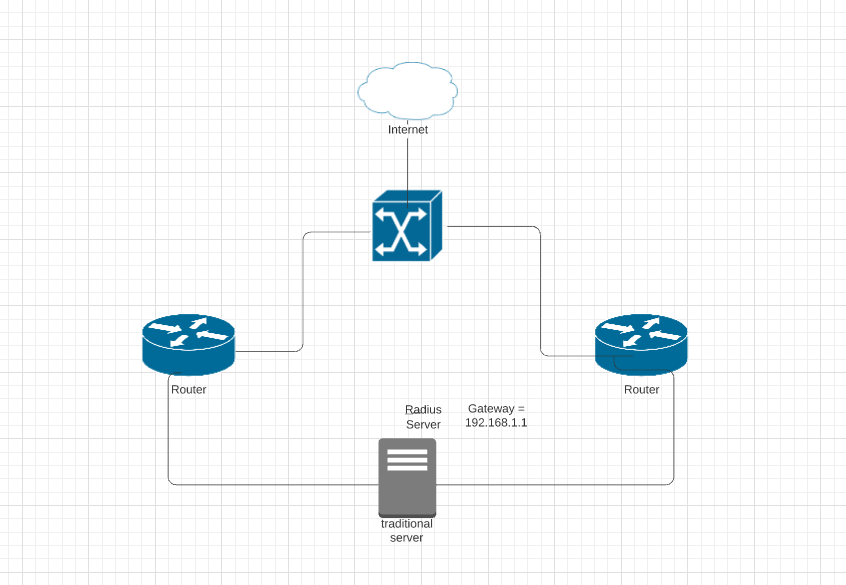

I have one Radius Server which on its gateway is 192.168.1.1 but is connected to two routers, my question is how do i set gateway address on each router and if one router fails?

How many LANs do you have?
Gateway functions upwards, not downwards.
Since according to your drawing your server is connected to both routers, then it already must use two gateways.
Just specify the IP of the router interface/bridge for each respective interface on the server.
Normally such two routers means at least 2 LANs. Ie. a multihomed server.
https://wiki.mikrotik.com/wiki/Manual:Interface/VRRP
Many thanks for replies - in VRRP examples ( https://wiki.mikrotik.com/wiki/Manual:VRRP-examples ) load sharing looks promising but as the radius server has just one gateway ( 192.168.1.1) , Could I set in R1 and R2 the same gateway IP?
