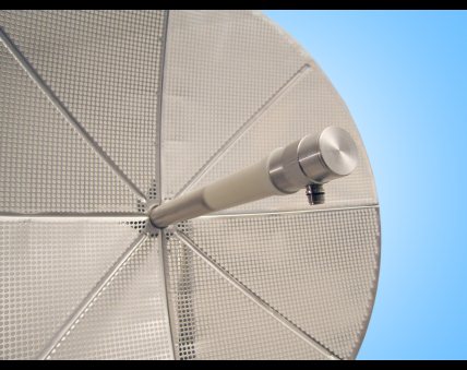

For a P2P link i am using a volt plus parabolic antenna 30db on both sides

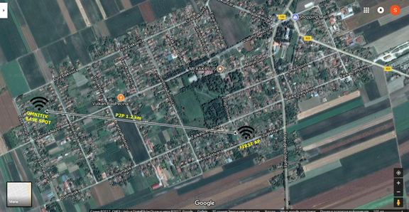

Now i am planning one more Base station for 15-20 customers
P2P link to that base station will be a setup with 2 X SXT5lite
And for a base station i am thinking about Mikrotik Omnitik 5 for deployment
The link distance is apr 1.5 km with clear line of sight
My packages to customers are WDSL 3.5Mbps / 512kb up and WDSL 6MBps / 768 Kb up
On customer site CPE it will be SXT5lite , Disc 5 or LDF 5 that i am right now testing
The question is Omnitik the right decision for a base spot in this situation?!
The picture is in the attachment.
The place is a small vilage with more than 300 houses.
There are 2 other AP stations that are running on 2.4Ghz so there is no frequency issues with my 5GHz tower.

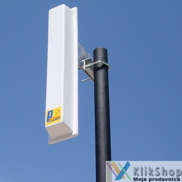

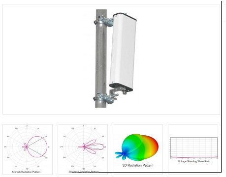

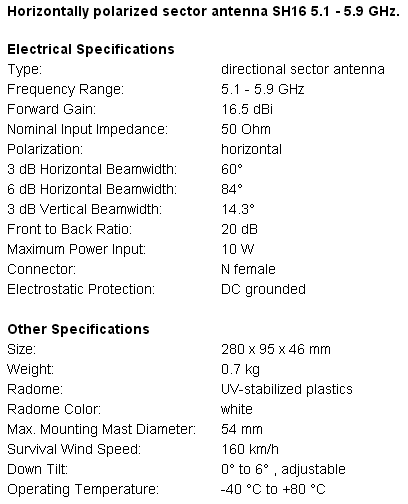

Second question for future use i am thinking about these two types of sector antennas
First is 5GSV16 (5GHz sector , 16dbi gain , vertical polarisation , horisontal angle 120 adn vertical angle 15
Second antenna is a sector DUAL antenna
No. Stay away from Omnis.
Basebox would be a good choice if only a handful, similar distance customers will use it, or to use it (PoE version) as a PoE Switch and reserve radio to carry out spectrum scans w/o disturbing customers.
Best choice for your scenario will be using an integrated sector, so that you get the best of both worlds: sector antenna with integrated radio, at more competitive price than purchasing seperate radio + antennas + pigtails, and one less failing component to care about: pigtails.
If you’re going to have really close customers (500m or less), my choice would be using multiple sectors like
If customers are going to be more distant, then would consider mANTBox 19S
