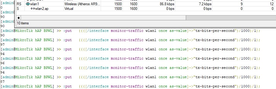

"Code to check wireless transmit speed:
ros_command(“:put ((([/interface monitor-traffic wlan1 once as-value]->"tx-bits-per-second")/1000)/100);”) "
from: https://wiki.mikrotik.com/wiki/Manual:The_Dude_v6/Charts#Data_sources
