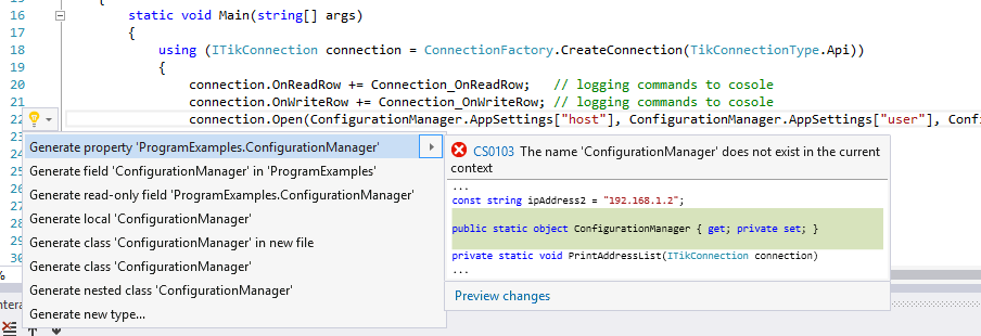

sorry for the question again
I open a new console project
call it tik4net.examples
install the packet you told me
but I get this error :
Severity	Code	Description	Project	File	Line	Suppression State
Error	CS0103	The name 'ConfigurationManager' does not exist in the current context	tik4net.examples	c:\users\computer\documents\visual studio 2015\Projects\tik4net.examples\tik4net.examples\Program.cs	24	Active
What I miss?

I think?
(Unless you have your own class called ConfigurationManager; tik4net doesn’t have one)
If you’re trying to run the example project, run it as a whole - don’t just copy the file into your own project. The “configuration” values are supposed to be edited from the App.config file.
No I don’t have one…
and I have download and copy the all code
any other idea?
Wait,
using System.Configuration;
did not work?
I mean, that one is part of the example code, and it is used at the very line your error message is.
no
this is all the code :

and this is the error I get :
Error	CS0103	The name 'ConfigurationManager' does not exist in the current context	tik4net.examples	C:\Users\Computer\Documents\Visual Studio 2015\Projects\tik4net.examples\tik4net.examples\Program.cs	22	Active
Ah… I see… If you’ve simply copied the code into your own project, that’s not enough, as “System.Configuration” is also a separate assembly.
You need to right click on “References”, select “Add references…” and add a check mark to “System.Configuration” before clicking “OK”.
(The example project solution does include it…)
I must say, Visual Studio’s error messages have gotten worse since I was actively using it… Back in VS2012, the error message did say “Are you missing a reference maybe?” which would immediately prompt you to check that very thing.
I’m very new at virtual studio–sorry ,
when I press right click and referance this is what I get :
On the right, where it says “References”… Right click on that.
(And after looking at the menus some more… “Project > Add Reference…” leads to the same dialog; I’ve just never used that particular way…)
now its running
but he say I have a problem in this line
connection.Open(ConfigurationManager.AppSettings["host"], ConfigurationManager.AppSettings["user"], ConfigurationManager.AppSettings["pass"]);
value can’t by null
but even if I change it to “10.0.0.1” “admin” “123456”
I get the same error
You mean
connection.Open("10.0.0.1", "admin", "123456");
Errors saying null is not allowed?
Or are you modifying App.config to that and still getting the same error? If the latter, you can go to “Project > Properties”, click “Settings” from there, and adjust the values from there instead.
this is what I did :
connection.Open(ConfigurationManager.AppSettings["10.0.0.1"], ConfigurationManager.AppSettings["admin"], ConfigurationManager.AppSettings["123456"]);
I didn;t change nothing in App.config
That’s not how the configuration manager works…
The values in the brackets are the names of configuration options specified in App.config. You don’t specify the values you want - you specify the name where the value you want is at.
And you don’t have settings with such names… In other words, the original code
corresponds to th original App.config file, where the settings “host”, “user” and “pass” exist.
The above line with the original App.config is equivalent to having hardcoded the line
connection.Open("192.168.4.236", "admin", "")
You only need to modify the App.config file so that instead of “192.168.4.236”, it ihas the IP you actually want to, and so on for the rest of the settings.
So to fix all this, change that line back to the above, and have your App.config file be

yes now it’s woring
Thanks ,
