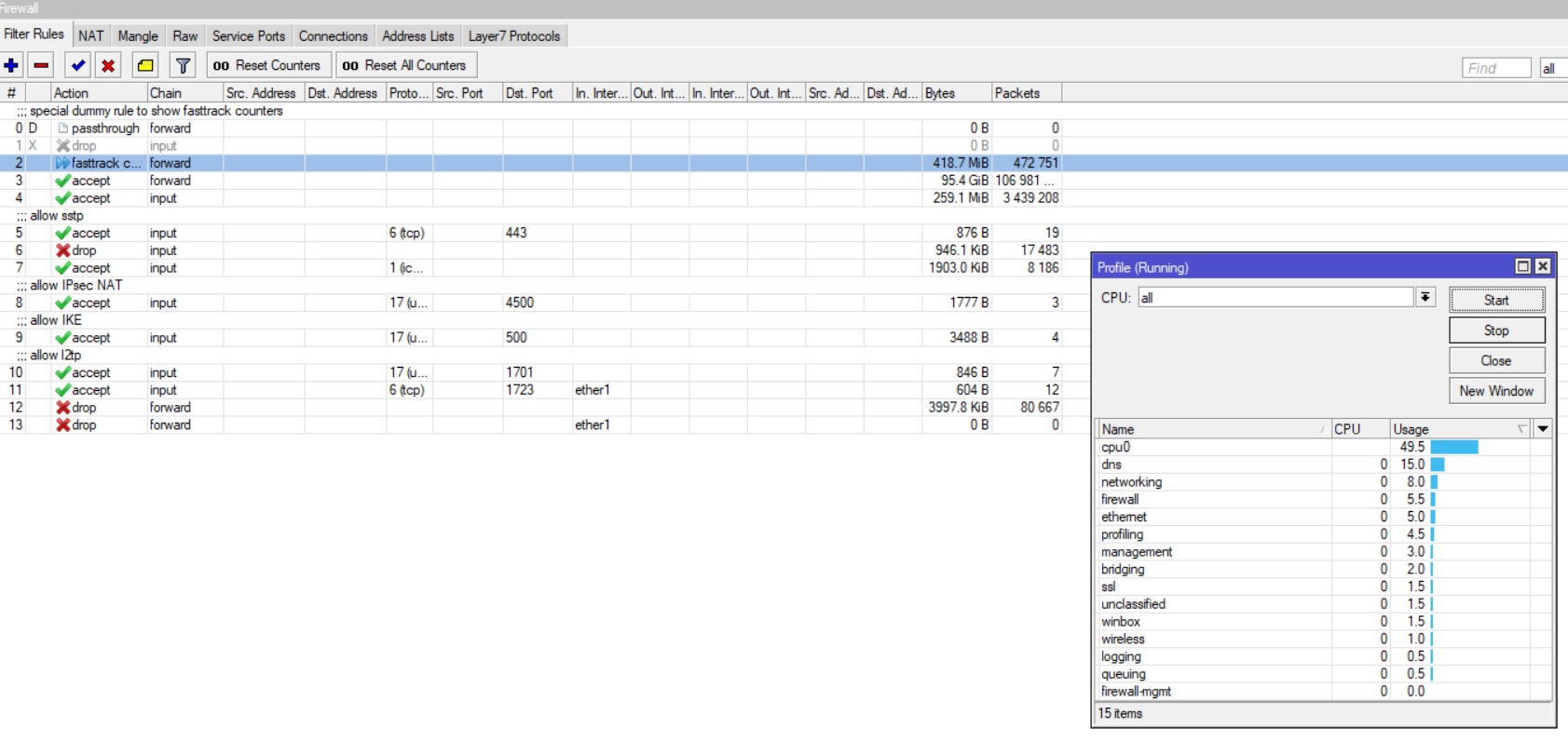

Getting a configuration suggestion
Greetings to the Mikrotik community,
Guys here’s the deal, we have a hotel which has been built from scratch by the Mikrotik router, switches, and groove ap’s. Recently I have been monitoring the router and I observed that the usage of CPU is abnormally at the peaks and the internet speed on the ap’s are slow.
In a nutshell, I’d like you guys to give me some suggestions in terms of the configuration and stuff like that.
Though I suspect that the firewall is not configured in order, please examine that thoroughly.

The major thing, which might help, is to move firewall rule
add action=fasttrack-connection chain=forward connection-state=established,related
right above rule
add action=accept chain=forward connection-state=established,related
As it is now, nothing gets fast-tracked (and fast-tracking does speed-up firewalling quite much).
However: you have queues set up … and fast-tracking things is not compatible with queues. (It may get close to being compatible but queues stuff has to be excluded from fast-tracking and if majority of traffic is subject to queuing, then the whole exercise becomes pointless).
You have to be aware that CRS is essentially a switch, not a (decent) router. The best approach would be to fetch a separate router (can be as cheap as a RB750Gr3) and use CRS as smart switch only.
Thanks for the reply,
I did what you said and I guess it seems to be dropping a bit, I just noticed that DNS is consuming a lot. There might be an issue on that?
Btw, do you think the queues are necessary in my case?
There are two things which are to be corrected:
  1. If I didn’t overlook something in the firewall filter list for chain=input, then access to DNS service from internet is allowed. Which is not good.
    There isn’t a rule allowing it indeed, but for sanity sake there should be a rule
add chain=input action=drop in-interface=ether1
(assuming that ether1 is your WAN logical interface … which is not if your internet came in via some PtP interface, such as PPPoE or VPN or whatever)
2. if you don’t plan to mangle DNS replies (or to server some static FQDN<->IP mappings about your own network), then you could let guests use public DNS servers directly … just set dns-server=8.8.8.8,8.8.4.4 in /ip dhcp-server network
That’s up to you to decide. Usually network administrators instate queues to limit throughput consumed by individual devices if WAN speed is limited … to give customers equal speed. If this is your position, then you’ll need queues. If you don’t care if one LAN device uses up all of internet bandwidth, then you don’t need queues.
If the internet service is for a hotel, why would you even consider allowing one guest to hog all the bandwidth MKX. There are times to get off your neutral fence and admit the obvious.
The more relevant question is if the router is also supplying internet for staff or VIPs where you might want to guarantee XX throughput at any point in time. Probably preferable to have a separate internet connection for those where queues need not apply.
As I wrote: it’s up to OP to decide, I know what I would do (but that’s not the point). I just mentioned a few possible reasons for choosing one over another, that’s all.
