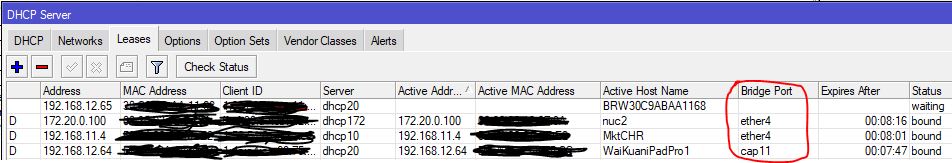

Getting Bridge Port from DHCP Leases in Terminal
I notice that in RouterOS 7.x.. the UI includes a column for “Bridge Port”
How do I get this listed in terminal?
Neither of these seems to include it in the results:
/ip/dhcp-server/lease/print
/ip/dhcp-server/lease/print detail
Seems useful to help me get which CAP interface a particular DHCP client is associated with.

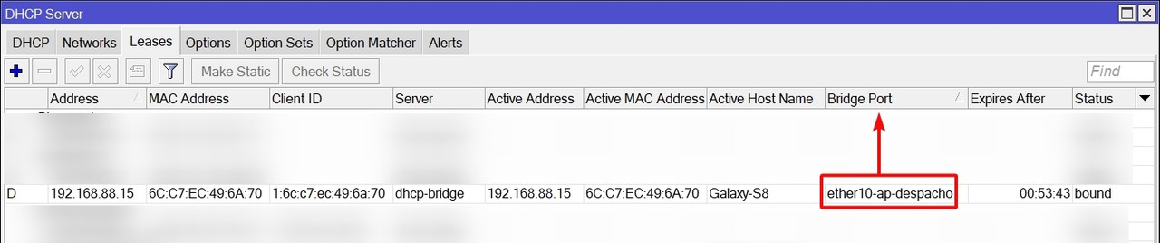

:put [/ip dhcp-server lease get value-name=bridge-port number=[/ip dhcp-server lease find address=192.168.88.15]]
Output:
input does not match any value of value-name
/ip/dhcp-server/lease/pr detail terse where address=192.168.88.15
Output:
0 D address=192.168.88.15 mac-address=6C:C7:EC:49:6A:70 client-id=1:6c:c7:ec:49:6a:70 address-lists= server=dhcp-bridge dhcp-option= status=bound expires-after=57m29s last-seen=2m31s active-address=192.168.88.15 active-mac-address=6C:C7:EC:49:6A:70 active-client-id=1:6c:c7:ec:49:6a:70 active-server=dhcp-bridge host-name=Galaxy-S8
In Winbox if this field appears:
BR.
Should be easy to fix, så MT please fix.
I have written an email to support but have had no response.
