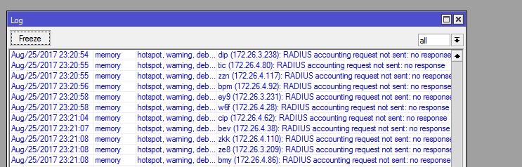

Can anyone please help me on below error i am getting:-
Getting Error: RADIUS accounting request not send: no respond

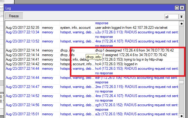

Your radius is not responding.
Check the hotspot router reaches the radius ip.
Check Radius service is not failing due to database problems, high load, or that it doesn’t have accounting enabled.
Is radius an external radius host, or user-manager running on the same device?
User-Manager is running on same device..
i checked and found that the database was full so i cleared the Logs and did the database rebuild but still getting the same issue but users are able to login
Look like the rebuild was not successful, the database possibly got corrupted due to lack of space.. You may need to clear it out and start from scratch, or have someone knowledgeable to inspect it if it contains useful accounting data.
