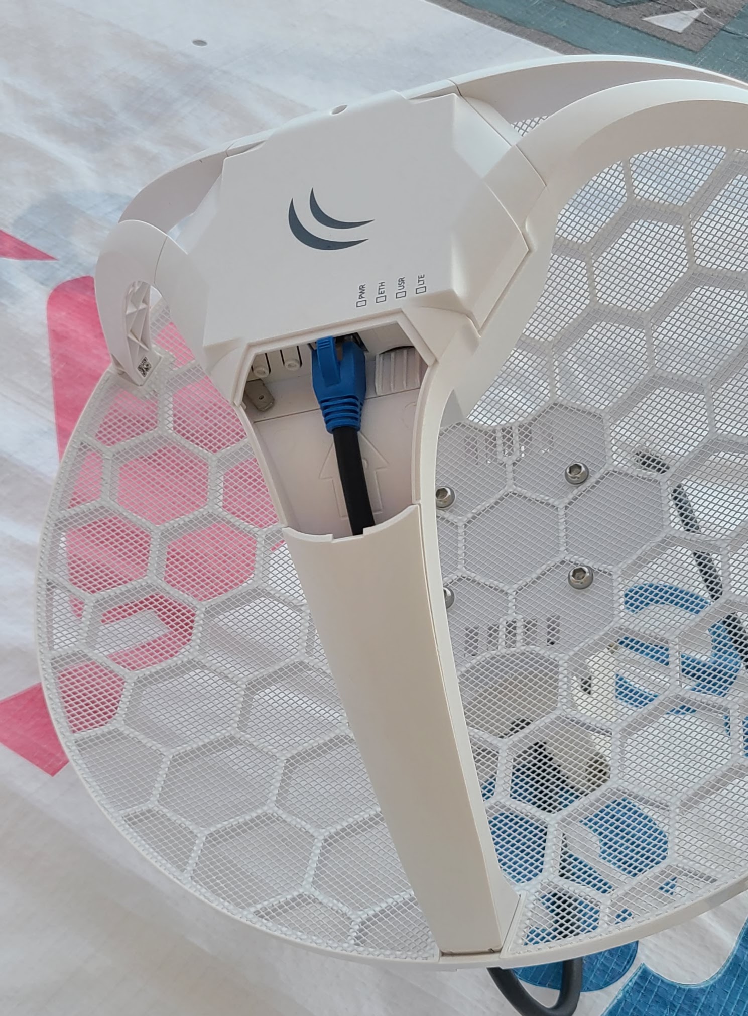

I have a LHG LTE6 kit and the plastic panel on the front was ripped off in the wind. Would it be possible to order a new plate? I really don’t want to cover it up with duct tape.

Maybe just not properly closed panel during installation. Maybe because of rubber connector hood cap? Just guessing.
Haha indicates a design flaw as many connectors have that tab on that side sticking out a bit.
Agree. But that’s minor design flaw (not for OP though), major design flaw would be if release tab of RJ45 connector would be facing the other direction. I’ve seen similar “gems” …
I have experienced the same, one needs a thin pry tool to push down on the tab but its doable, better than losing the cover!!
It is a special cable however I would have cut the blue release part off. If you fit the panel it would pushes down the blue tab which releases the connector.
I hope your reseller can get a replacement panel for you and till then, tape it off.
