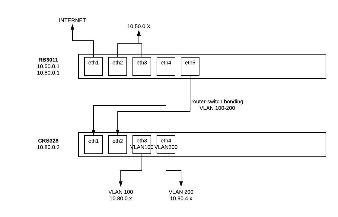

I'm trying to build a new network with VLAN and bonding and i'm having a lot of trouble getting it up and running.
I have a RB3011 as the main router, which has been working fine for the last 3 years. The current network setuped on this router is 10.50.0.1/24
I just bought a new CRS328-24P-4S+RM to use as my main switch.
I want to create 2 new VLAN where i will move all my machines to eventually. VLAN 100 (10.80.0.0/22) and VLAN 200 (10.80.4.0/22)
Also want a bonding interface between both the switch and router.
Here is a diagram of how i would like things plugued.
I have tried this. Here is my current config:

The bonding seems to work fine and i'm able to ping to 10.80.0.1 which is the adress of the router VLAN 100. However i cannot ping the switch or anything else on this network.
Anything i'm missing ? Let me know if you need more information.
Thank you.
