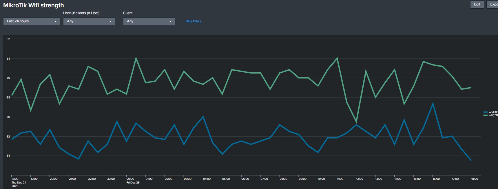

I do use Splunk to monitor this. There I can look at any give time period. If you have paid version it can also send email for any triggered alert you setup. Here is an graph of strengt from two wifi devices.
