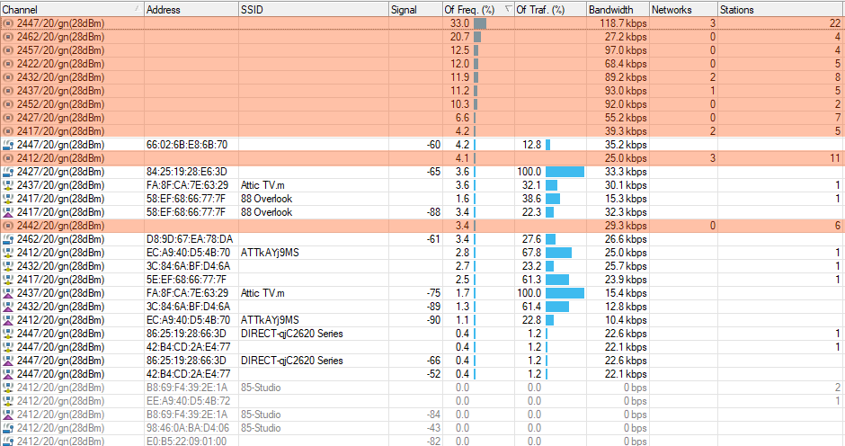

I performed a wireless snoop and I am confused by the number of records that have no data and report a large number of stations. (attached).

What are these records in the snooper with data and what is the relevance of the station count associated with them, if any?

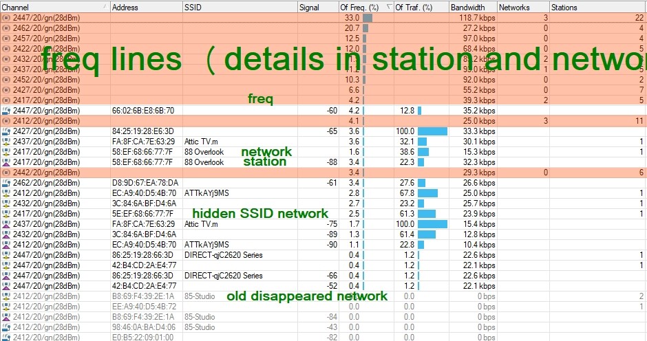

In Snooper, you have frequencies (channels), networks and stations. Frequencies do not report MAC addresses, they are in the network and station lines.
Either use the filter (upper top right, then you will also understand the different symbols), or sort them by channel. (Frequency lines are a consolidation of networks and stations)
@bpwl - I appreciate the response, but that doesn’t answer my question, I did have a typo so maybe that makes a difference:
What are these records in the snooper without data and what is the relevance of the station count associated with them, if any?
You simply say, “oh those are just frequencies”. But what does that mean? Is it just random noise or are there data packets on it? If there are data packets on it what are they?

What do you mean without data?
  • sometimes SSID is missing (hidden SSID network, not well decoded SSID, non-802.11 based device (nv2 will be recognized by snooper as it is also MT) but other protocols will not be decoded.
  • sometimes power reading is missing or is also missing
  • signal that is not current will be grayed out
  • freq lines show # of networks and stations seen on that freq. (channel information may leak to adjacent channels, so you may see in 2417 a 2412 station)
  • sometimes information is seen double (small differences for snooper) but with the same MAC address
  • the microwave oven has no mac address, but bluetooth will probably appear with no other information but MAC address (I never managed to identify a bluetooth so far.)

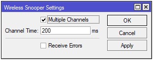

    If you set “receive errors” enabled in “settings” you may see more lines, but with some errors in the decoded information (typical are weird SSID names)
    And DO click on “channel”, to sort the lines per freq. There you will see that freq line is the consolidation of the network and station lines (sum may not be correct as thing come and go rapidly).
    Or do use the upper right filter to show networks or stations only.

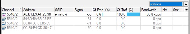

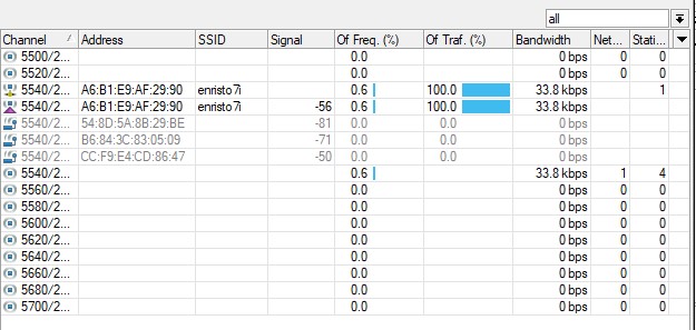

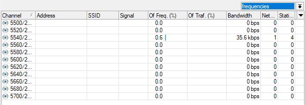

Simple example: Omnitik looking at ISP modem in other room. One AP, one station being the AP itself, 3 xxxx from neighbors
All view (remark: frequency= AP= stations in traffic)
Freq sees 1 network and 4 stations in the same freq
network sees 1 station in that network
(the 3 neighbors are silent now)
Selective view (screenshot takes some time, so data is not consistent)
