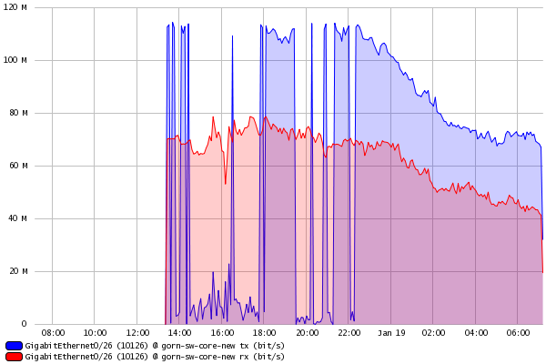

I have some gigabit links loaded for 300-400Mbps. The Dude correctly display the hour graphs for them. But while hour link history graph for gigabit links is quite right the corresponding day, week, month and year’s graph never surpass 100-120Mbps and look oddly.
When the load on some Gigabit links fall below 100Mbps all graphs become corrects.

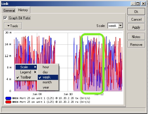

I have similar problem.
It seems some type of counter overflow when summarizing data.
I seen this problem with MRTG too.

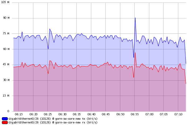

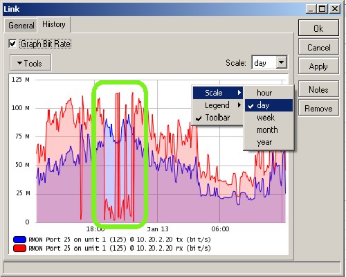

I have the same problem:
Hour’s graph is ok always:
Day’s graph is not while throughput exceed 100-120Mbps:
Looks like a problem with wrapping 32-bit counters. A 32-bits counter will wrap if the bandwidth is over 100 Mbit, and the time between polls is about 5 minutes…
You can try to poll the device more often, or maybe the dude could support 64-bit counters instead…
Replace Cisco and use RouterOS vs SNMP to graph ?
SNMP v1 (and v2 I think) are indeed limited to 32-bit counters and can therefor quite easily overflow. SNMP v3 (or was it already in v2?) introduces some 64-bit counters, so that should work better…
I don’t think this is SNMP version issue because hour graph is correct and daily graph do not depends on SNMP’s counters size but rather on the averaging-out function.
You are correct. If the hourly graph is correct, it can’t be overflowing SNMP counters and it must be an internal Dude problem…
