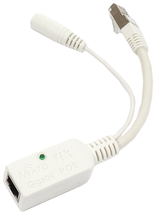

Is there plan to make http://routerboard.com/RBGPOE
with shielding?
How to schielding 1Gbit routerboards, when we have only RBGPOE (non schielding)?
They are shielded, I just checked. We will update the photo make it clearer to see.
Ok, in this case we have old revision. Non schielded
Hello Routerboard team,
we have problem with new (shielded) revision of gigabit PoE injectors:
We are using them in our PoPs, where we have common -48V DC voltage (standard telco PSU with + pole connected to ground).
The old version of RBGPOE hasn’t any shielding over RJ connector and works fine for us providing 48V DC power directly to powered devices with gigabit ethernet ports.
The present version of RBGPOE has shield connected on both male/female RJ connectors, which is fine to protect powered devices, but the problem is: this ethernet shields are internally connected inside RBGPOE to minus pole of DC circuit, which we consider to be wrong.
If we use new (shielded) RBGPOE at our site we get short circuit from minus pole to shield at RBGPOE and then to plus pole of central PSU which is grounded according to telco standard.
Please can you consider to redesign RBGPOE in a such way there will be no connection from RJ shields to DC power at all? Just both RJ’s shields should be connected together as they are now, but not to the DC jack.
The present design of RBGPOE can be dangerous to powered devices too, because it provides minus pole on RJ shielding which may or may not be expected at target powered devices (RBs etc.). Shielding shouldn’t be connected to PSU, but only to the central ground point, which is in case of RBGPOE shielding at metal case of switch or similar device where the RJ male side of RBGPOE leads to.
Joddi
Thank you Joddi, we will consider these suggestions for the next manufacturing batch. I have forwarded your complaint to the responsible people. Thank you
