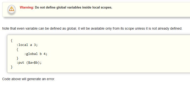

I remembered this from the Wiki / manual:
There is a solution
http://forum.mikrotik.com/t/send-public-ip-to-telegram/156953/13
