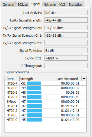

Here’s how the link looks in Winbox:
CCQ varies ~75% - ~95%.

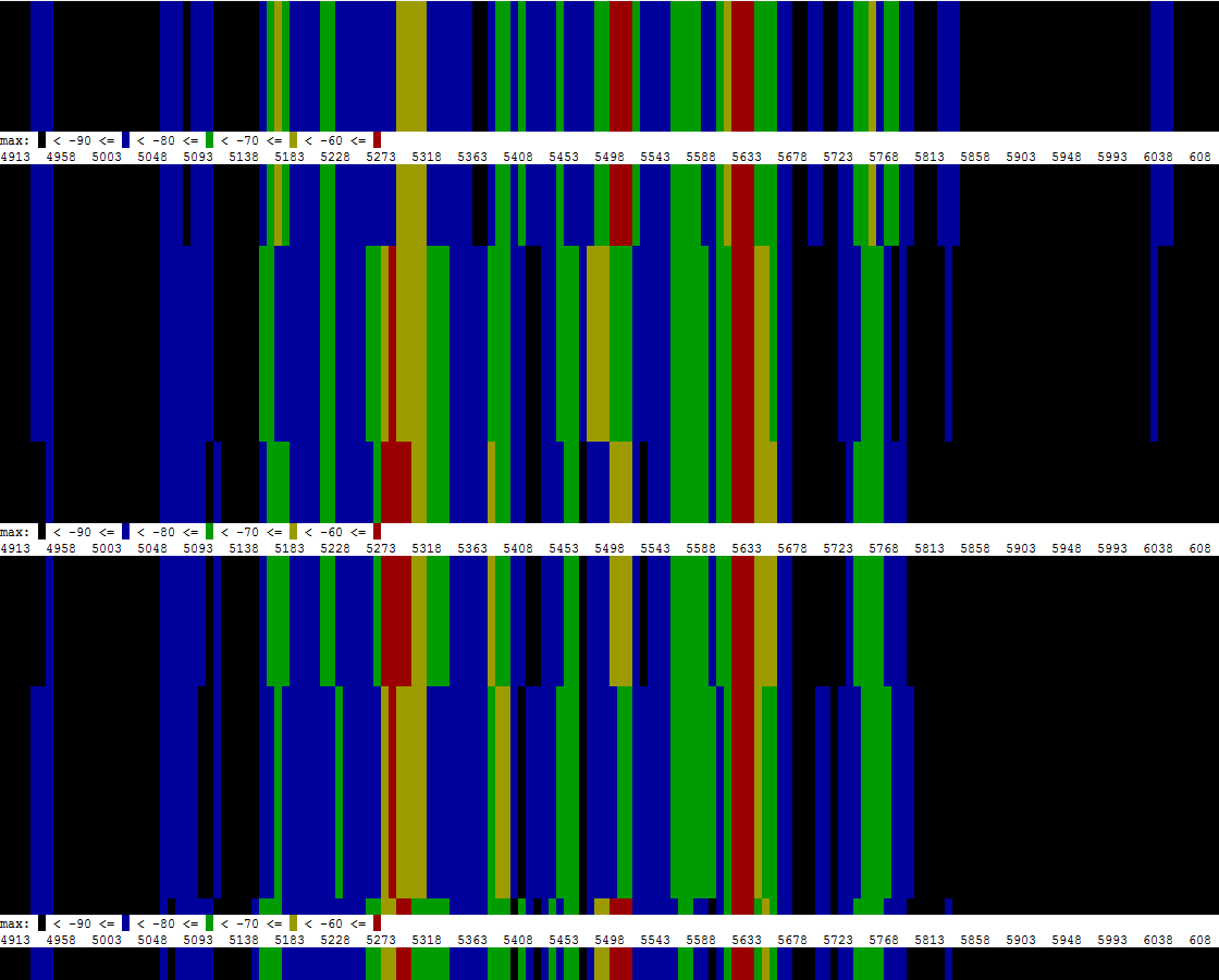

What does a
/interface wireless spectral-history range=5ghz 0
looks like? (please give it a couple minutes running)
The frequencies are separated as much as possible and the bridge is the only one not working properly.
Here’s some spectral history:
I can use frequencies 5180-5700.
