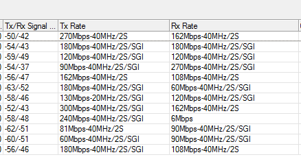

I have an AP setup with some clients connected to it. The quality of the link is good as well as the speed. Yet clients connected to the AP are complaining of drops in packets.
I need suggestions on what to do to resolve the issue. I have also attached the values of the signal strength and speed to this message

@vecemik87…from the AP, the CCQ value is not displayed but showing on the client’s radio with an average value of 52/40%. Also clients are complaining that the link is slow despite the quality of the signal strength and speed.

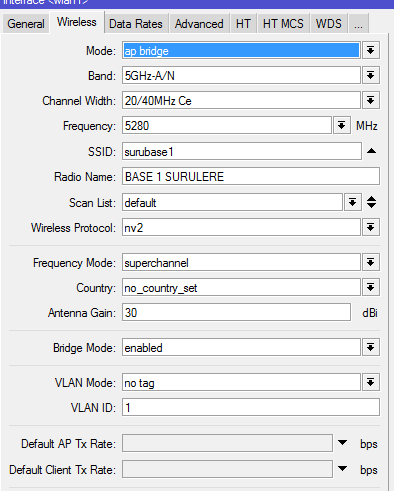

The config on the wireless card for the AP is in the attachment.

I can’t see anything clearly wrong in this tab of setting (except “superchannel” and missing country which should never appear in real conditions) Yet, CCQ value is really low and points towards wifi loosing packets.
