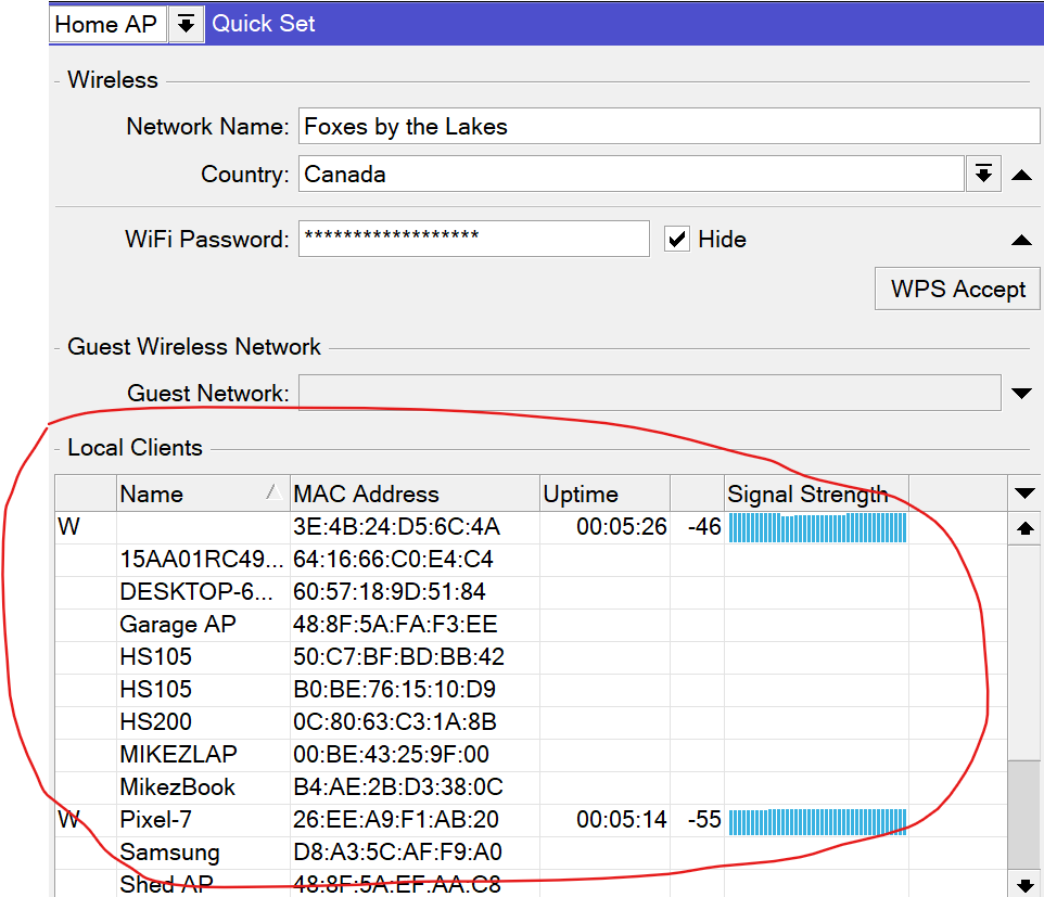

The reason I thought they weren’t is because their signal is not showing up on the Quick Set Local Clients list
The L009UiGS-2HaxD is still pretty new though so perhaps that’ll get fixed in a future firmware update
:folded_hands: Mikrotik plz fix :folded_hands:… and thank you for the great products!1!!
Probably, it is better to go to WiFi > registration to check the list of clients. AFAIK, the quick set screen should be used only once for the initial configuration, hence I don’t think mikrotik investested/will invest much effort in fixing that.

Aww, I hope they do, I love that graphical Signal Strength graph/column. Or maybe add that along with “Name” to the WiFi registration tab - that’d be SO sweet!:ok_hand:

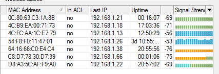

However, I just found out why those HS105 weren’t showing up on that list - it’s because they all chose the garage AP instead :skull_and_crossbones:
Garage AP:
Thanks so much for all these tips @ips!! I’ll send that suggestion to the dev’s
