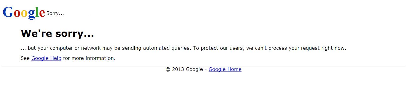

Hello guys!
The only forum that I know who can help me is this. see attached image from google when I try to search. At first it was only asking for captcha, then after 2-3 days it will show like this. I am not sure if my MT is causing the problem or is there any workstation causing this. Is there anyway to fix this from my MT? thank you in advance.

First of all, check if someother in the world not using your proxy because you miss to close web-proxy port on firewall.
It’s one missing feature on RouterOS software:
http://forum.mikrotik.com/viewtopic.php?f=1&t=85085&p=428538#p428538
http://forum.mikrotik.com/t/please-include-the-possibility-of-anonymous-proxy/76064/6
RouterOS 6.14 fix this (wait the final version)
Thank you rextended.
I cant manage to wait anymore. Thus, downgrading the version can fix the issue?
obviously not, or I have suggest that.
rextended,
I did disable the MT webproxy, but the problem still occurs.
But when I changed my WAN IP the problem disappears,but whenever I try to use the previous IP the google search is acting up again. I also noticed that my upload speed reach to the maximum level whenever I am having issues with google. Is there anyway in MT to check what address(work stations/ ports) are getting too much traffic specifically upload traffic? thank you in advance!
When you go on one “blacklist” is needed time before Google leave you from list…
