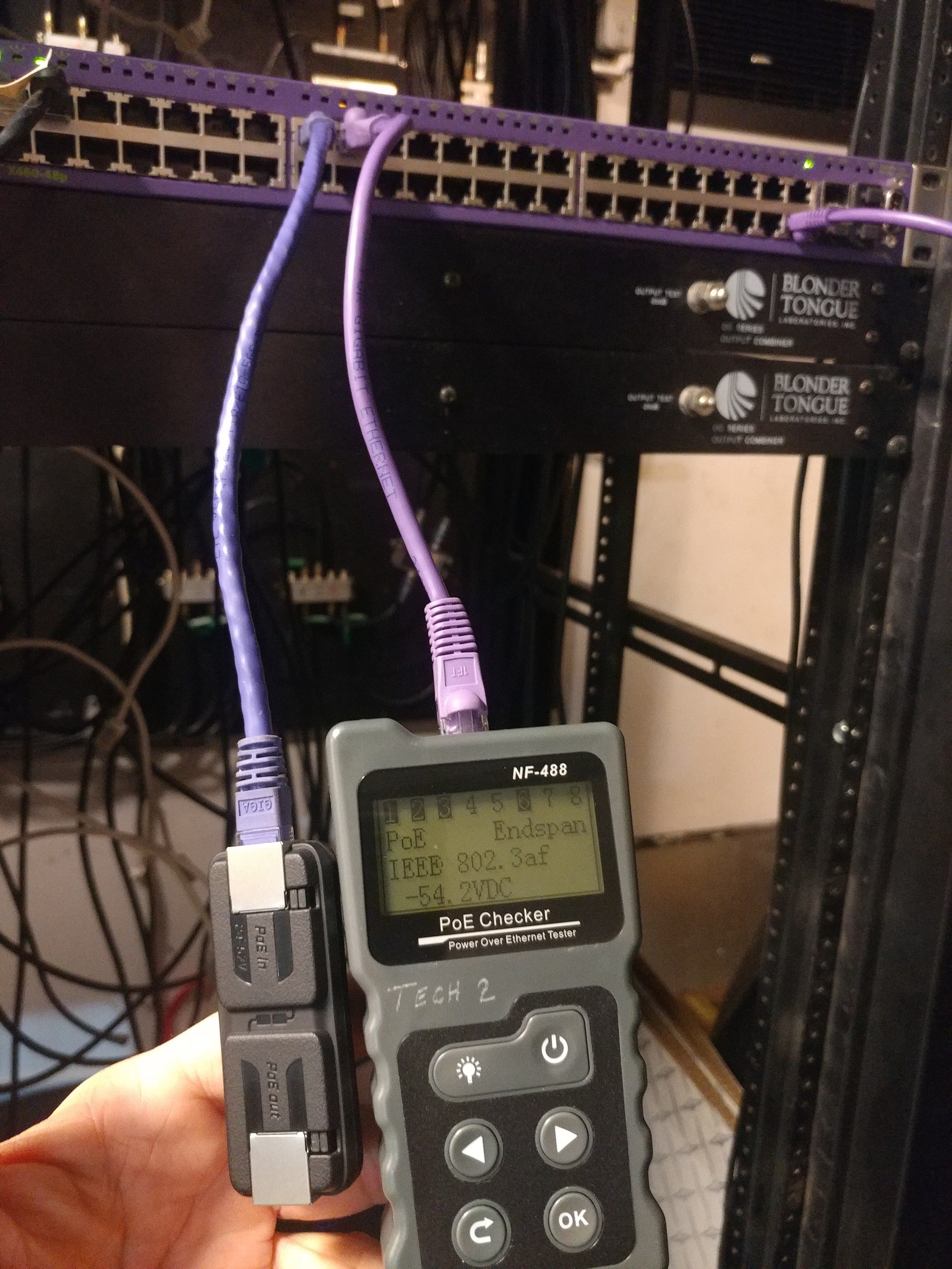

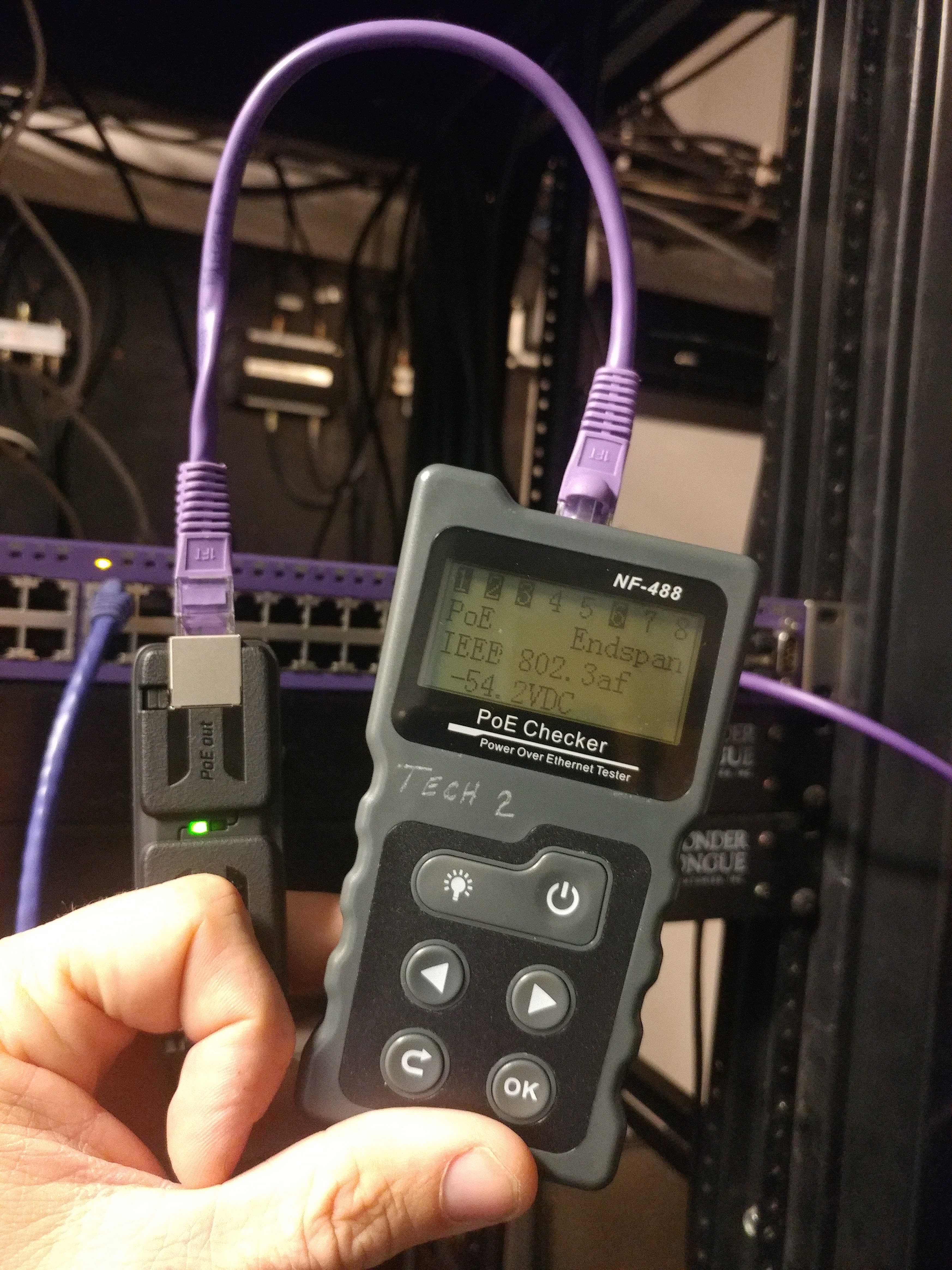

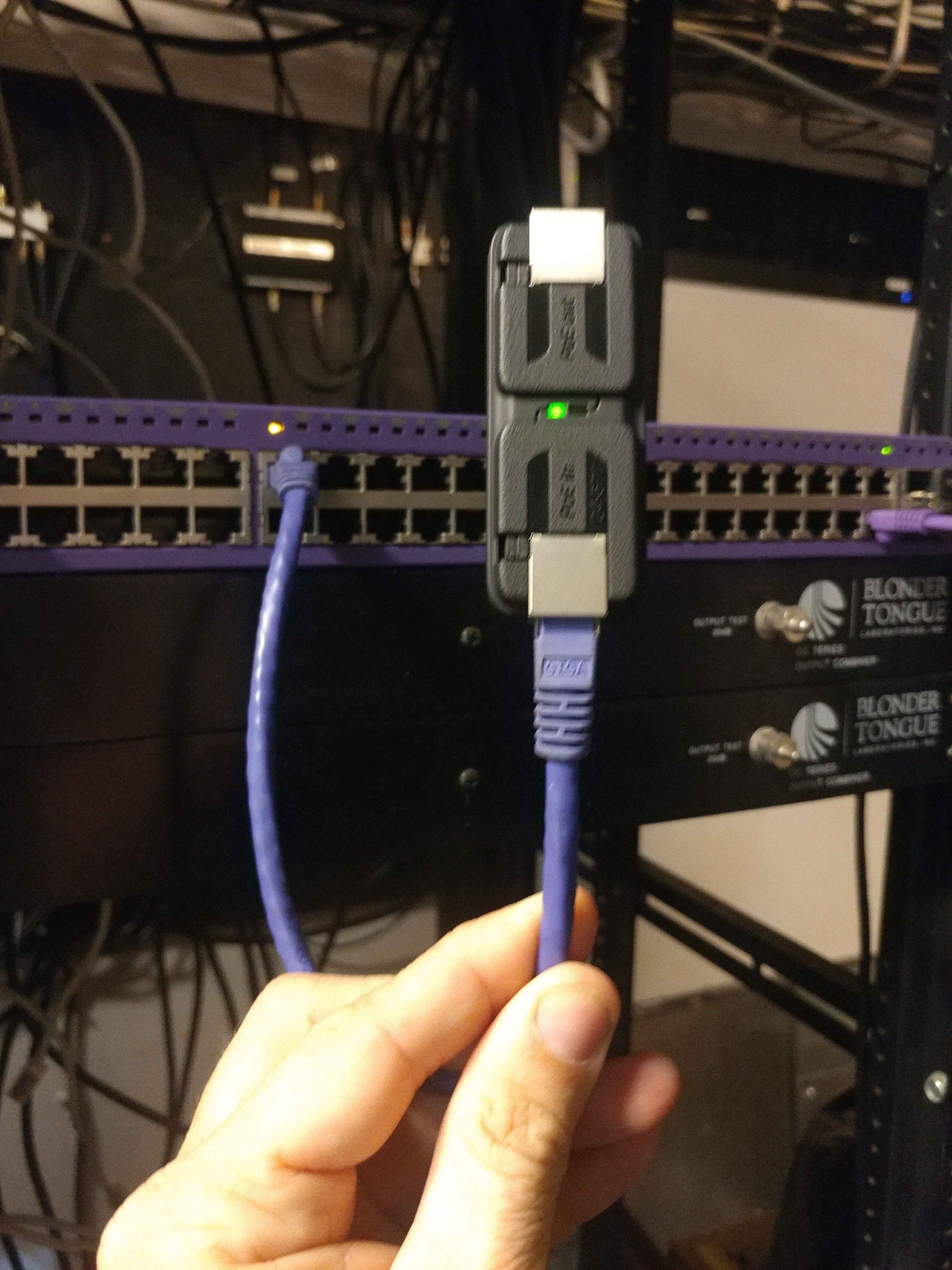

Here are 3 photos that show it will not power up on it’s own.
Photo 1: GPeR is connected to 802.3af switch with tester in adjacent port proving power is available. GPeR does not power up. No LED light.
Photo 2: GPeR is connected to 802.3af switch, tester is moved to the GPeR OUT and it now powers up.
Photo 3: Tester is removed, GPeR stays powered up. I can then connect my laptop and it works.
Removing the 2 OUT jumpers does not fix the problem, I can’t get it to power up at all then.

The 802.3af standart needs to negotiate some things with the receiver device. It works well, if you are connecting through the GPeR to some 802.3af compatible device. But if you are only powering the GPeR itself, with disabled PoE passthrough, it will not work, as the GPeR itself can only be powered by Passive PoE injector. We will clarify this limitation in the GPeR documentation

This will only work if “PoE in” is served by passive PoE source, as 802.3af/at switches will not be able to power the GPeR itself.
