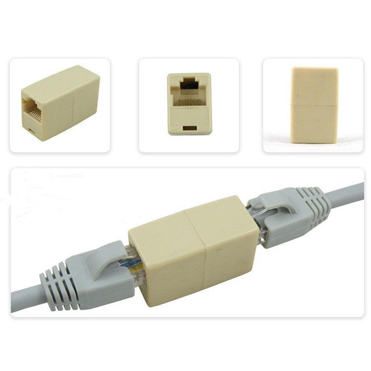

I think we can say that these GPERs are "passthrough" devices.
If you apply on one side passive poe (forced on) there will be passive PoE on the other side.
If you apply on one side 802.3af/at, the connection is "transparent" and IF you connect on the other side a device capable of completing the 802.3af/at negotiation, THEN there will be PoE on the other side.
Imagine that INSTEAD of a GPER you have a simple RJ45-RJ45 coupler connector like:
