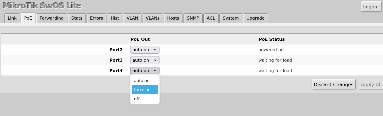

Does PoE Output support active (af/at automatic, default) and passive (forced on, forced off) in SwOS Lite?

Yes you can force on the outputs:
And there is no voltage/current monitoring unfortunately.

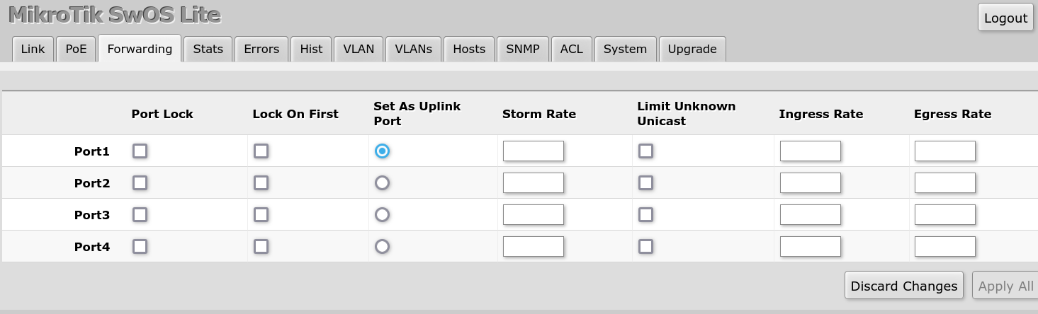

Also like other SwOS lite devices you can select which port is the uplink:
