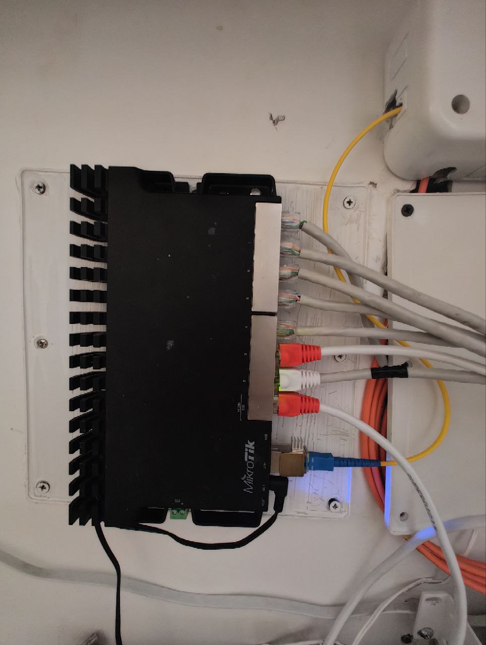

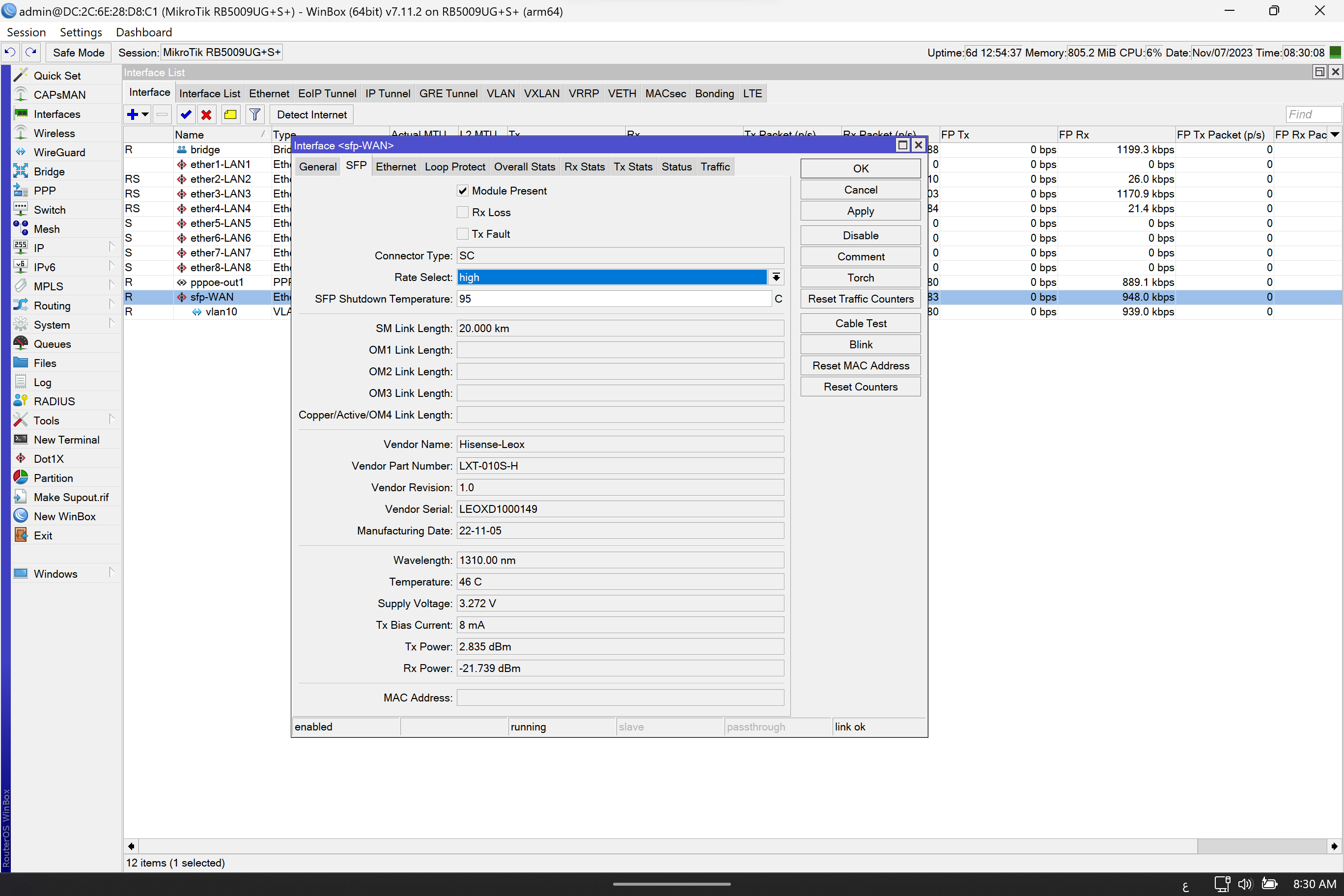

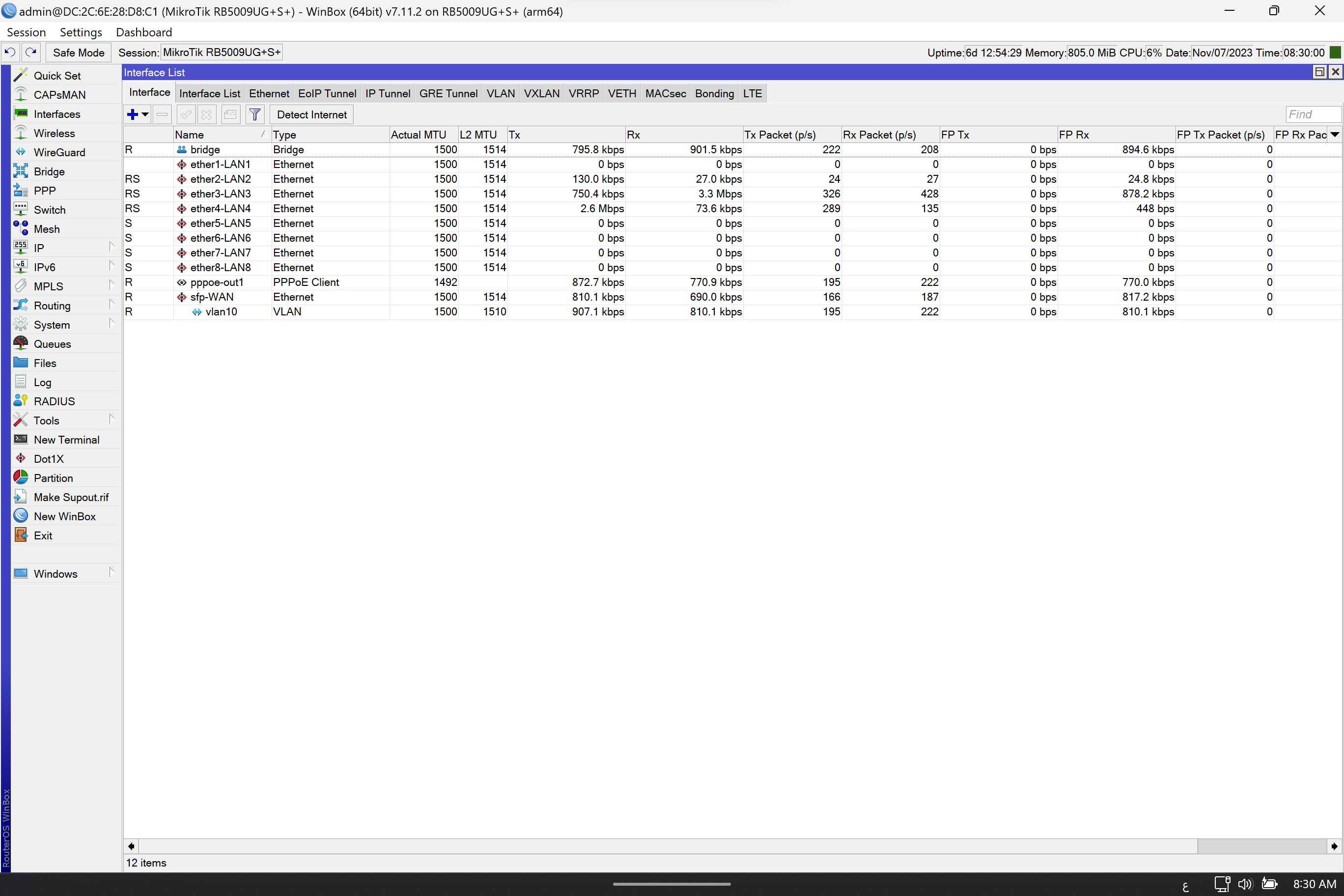

actually, my ISP installed Huawei EchoLife HG8240T5 and I replaced the Huawei with GPON STICK LXT-010S-H from LEOX and connected to MikroTik RB5009UG+S+ and works great vlan for internet and I got static IP but I don’t know how to setup vlan for iptv and voip

more details
